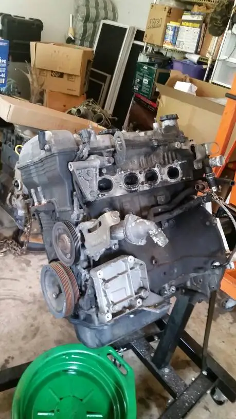

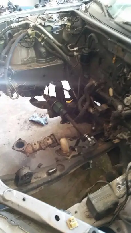

So we then started taking things apart and pulled the motor out.
Then we began taking the motor apart.
View attachment 213143View attachment 213144

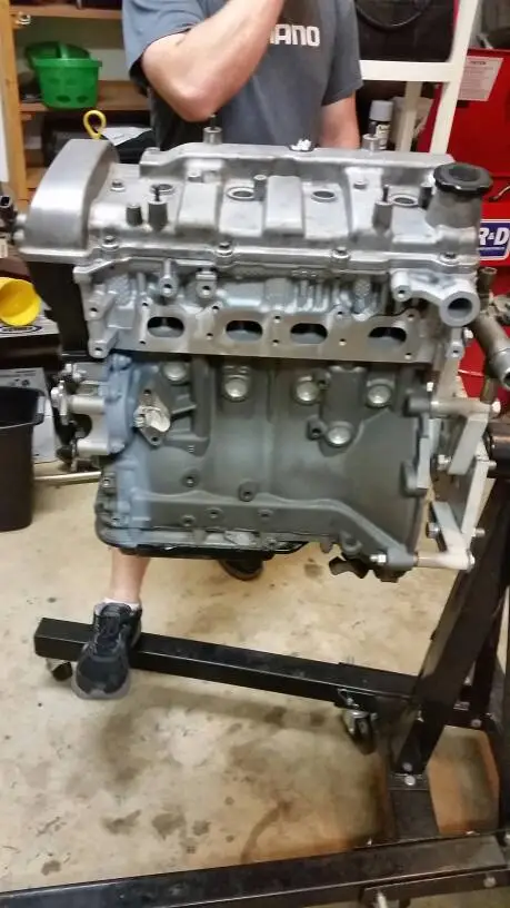

View attachment 213146View attachment 213147

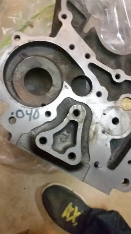

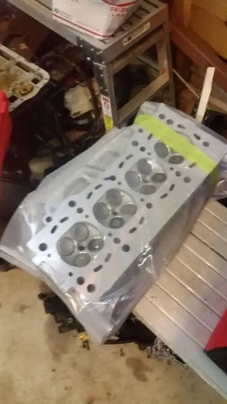

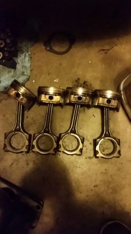

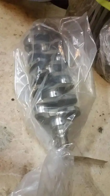

I took the head, crank, block, and flywheel to get resurfaced. I also bored the block .040 over. uploadfromtaptalk1454863189973.jpguploadfromtaptalk1454863235595.jpguploadfromtaptalk1454863252580.jpguploadfromtaptalk1454863271106.jpg

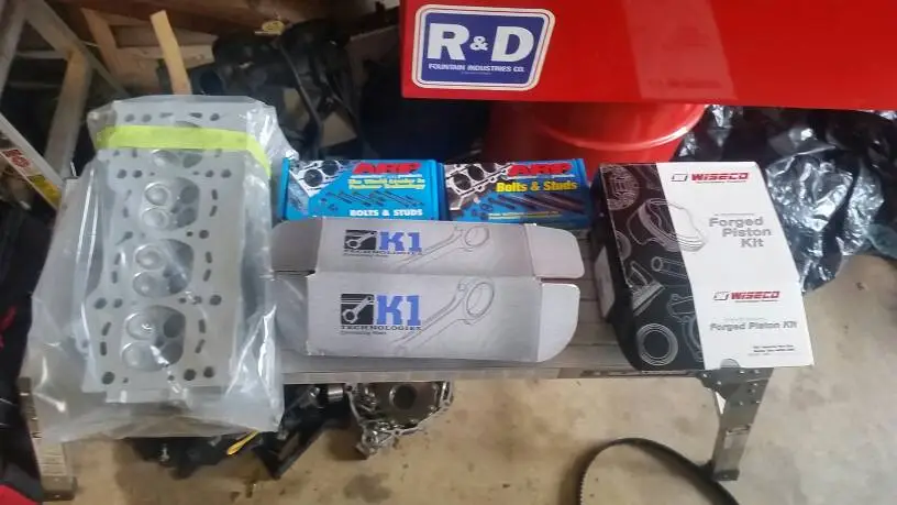

I then started ordering parts.
ARP Bolts, gasket kits, water pump kit, Wiseco pistons, K1 rods, oil squirters.
I also bought FMIC, hardpipes, new BOV,
Radiator, electric fans, new belts, corksport exhaust, air intake from street unit, and pope exhaust manifold.
I took the head, crank, block, and flywheel to get resurfaced. I also bored the block .040 over. View attachment 213148View attachment 213149View attachment 213150View attachment 213151

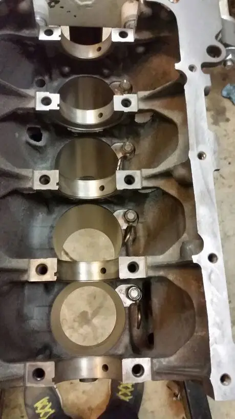

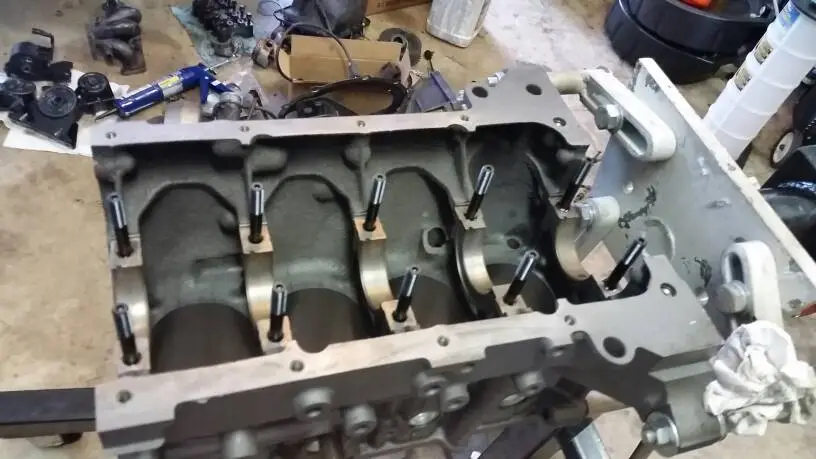

Now we started putting everything back together. uploadfromtaptalk1454866145968.jpg

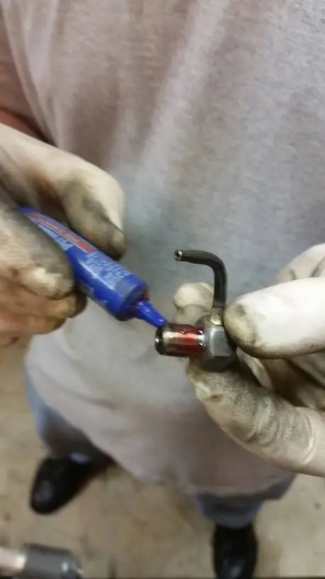

We took a screwdriver and a rubber mallet and began to gently tap out the oil squirters. 2 came out easily the other 2 we had to give a couple of good hits for them to come out. We then put loctite on the new ones and carefully tapped them in as well. uploadfromtaptalk1454866298471.jpg

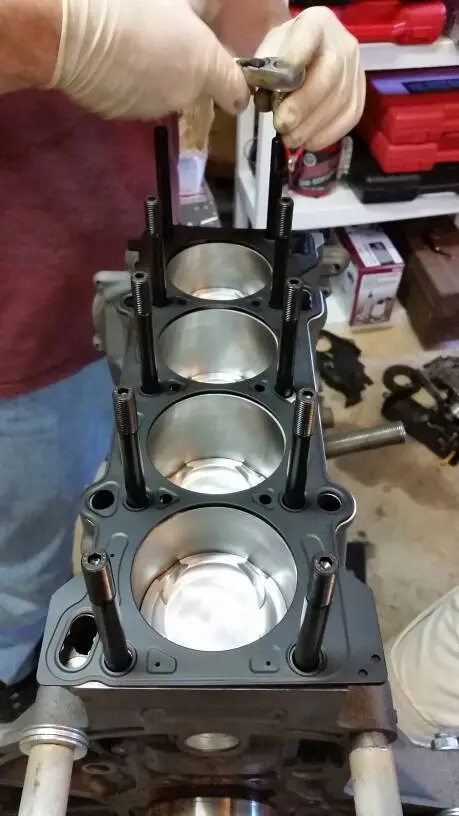

We then started with the ARP bolts.

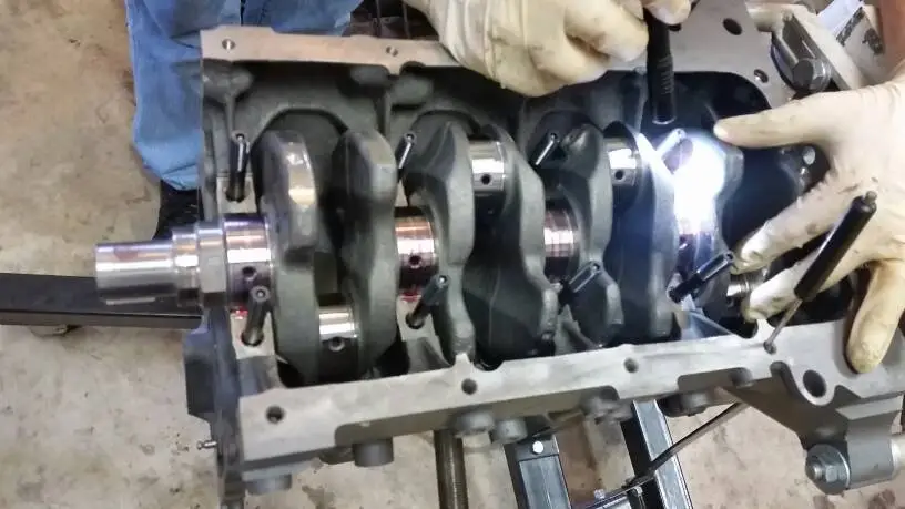

And then the crank.

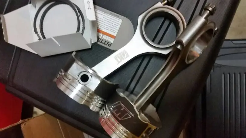

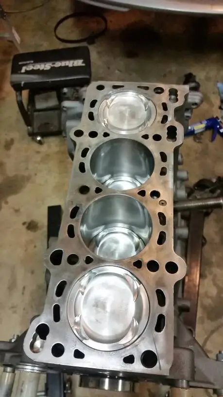

Then we started putting together the rods and pistons.

Now we started putting everything back together. View attachment 213153
We took a screwdriver and a rubber mallet and began to gently tap out the oil squirters. 2 came out easily the other 2 we had to give a couple of good hits for them to come out. We then put loctite on the new ones and carefully tapped them in as well. View attachment 213154
And then the crank.

So then we started installing the pistons. When installing we greased the bearings for lubrication during first start up, that way things are lubed up until oil gets back to flowing to everything. Also we lubed the sides of the pistons and put a little oil on top of the pistons and starting turning the crank to make sure everything was in line and moving smoothly. uploadfromtaptalk1454870380907.jpg

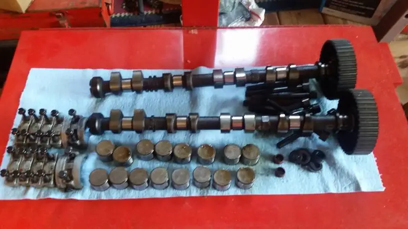

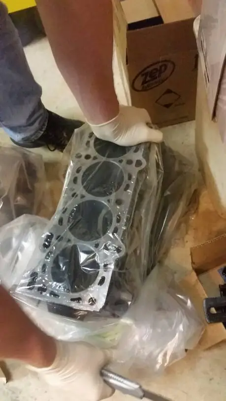

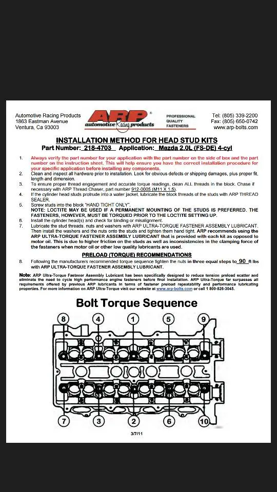

Then we added the gasket and the other ARP Bolts. And put the head, cams,and valve cover back on. I attached the arp head bolt sheet as well.uploadfromtaptalk1454870430264.jpguploadfromtaptalk1454870652638.jpguploadfromtaptalk1454870669310.jpg

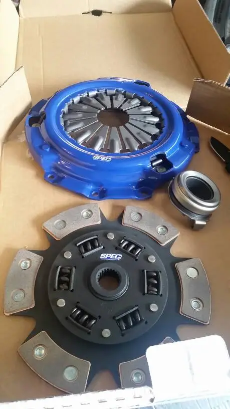

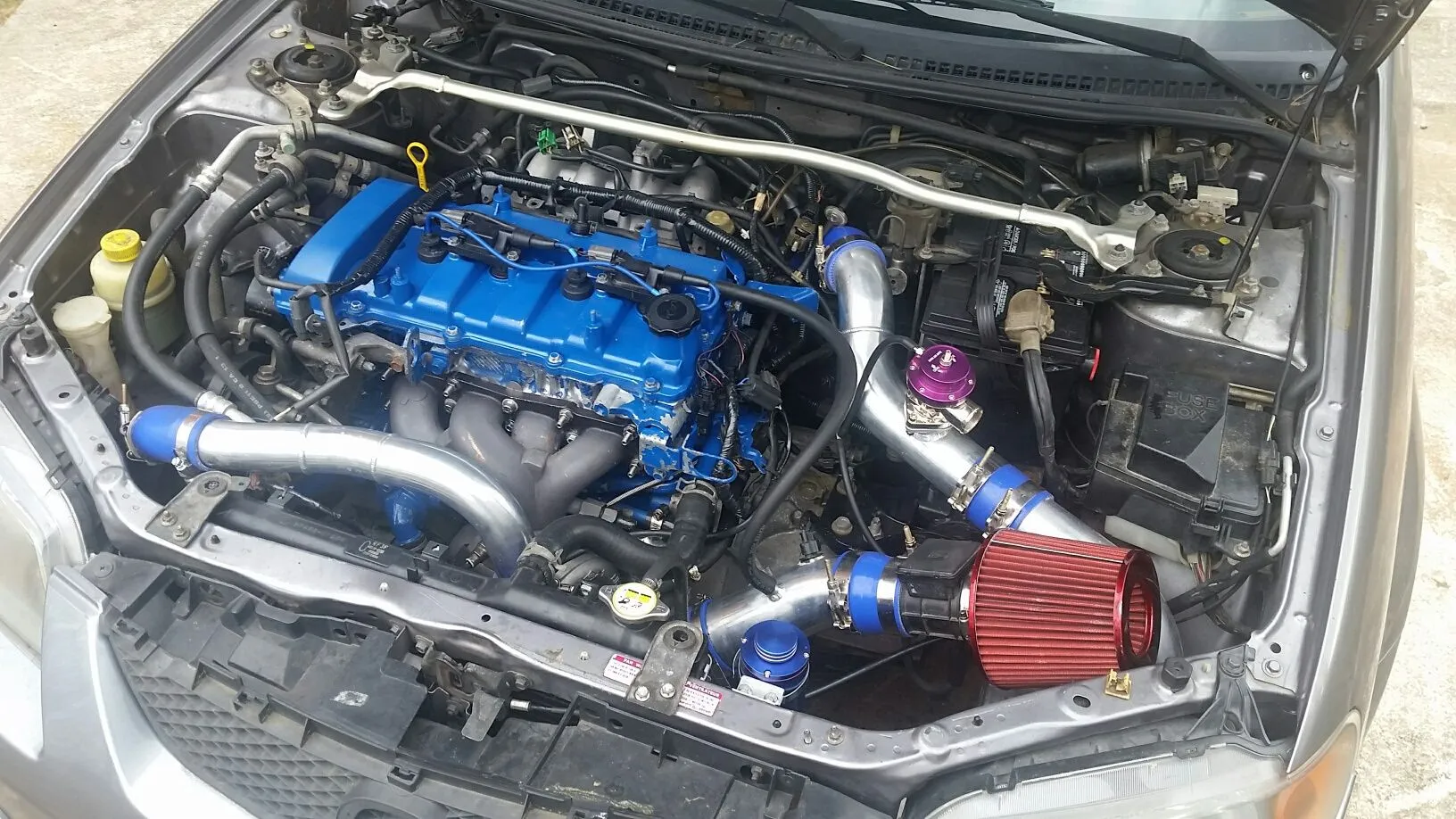

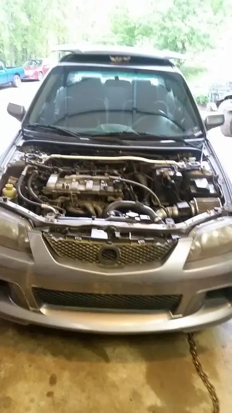

Then I got a spec stage 3 clutch from street unit. uploadfromtaptalk1454870730244.jpg
