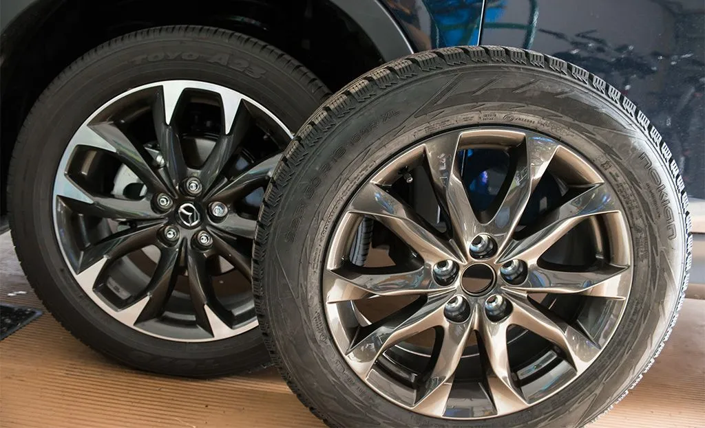

I as well recently decided to purchase a set of wheels & snow tires before the winter season. For me, it was a compromise between functionality, looks and compatibility. I wound up paying a lot more though!!! I chose the Nokian Hakkapeliitta R2 SUV (225/60R18) snow tires with new Mazda3 18" gunmetal rims (B45B-V3-810). Cost was $735 for the tires and $936 for the rims less s&h and mounting. The weight of a mounted tire on this rim is 54.5 lbs. The fitment of that rim is 18x7", 50mm offset, 5x114.3mm bolt pattern, 67.1 hub center bore.
I don't have a picture of them on the vehicle, but I took a snapshot of one next to it:
attachment.php
I stole the idea for the Mazda3 18" rims from Fendyman's post:
http://www.mazdas247.com/forum/showthread.php?123817319-Show-me-your-wheels&p=6348806&viewfull=1#post6348806
Opticalman.........great idea, I like it. Sure, it cost a few more bucks, but it looks wwwaaayyy better than steel rims. Plus you'll love those Nokian Hakka R2's, have them on our CX and they work awsome.
