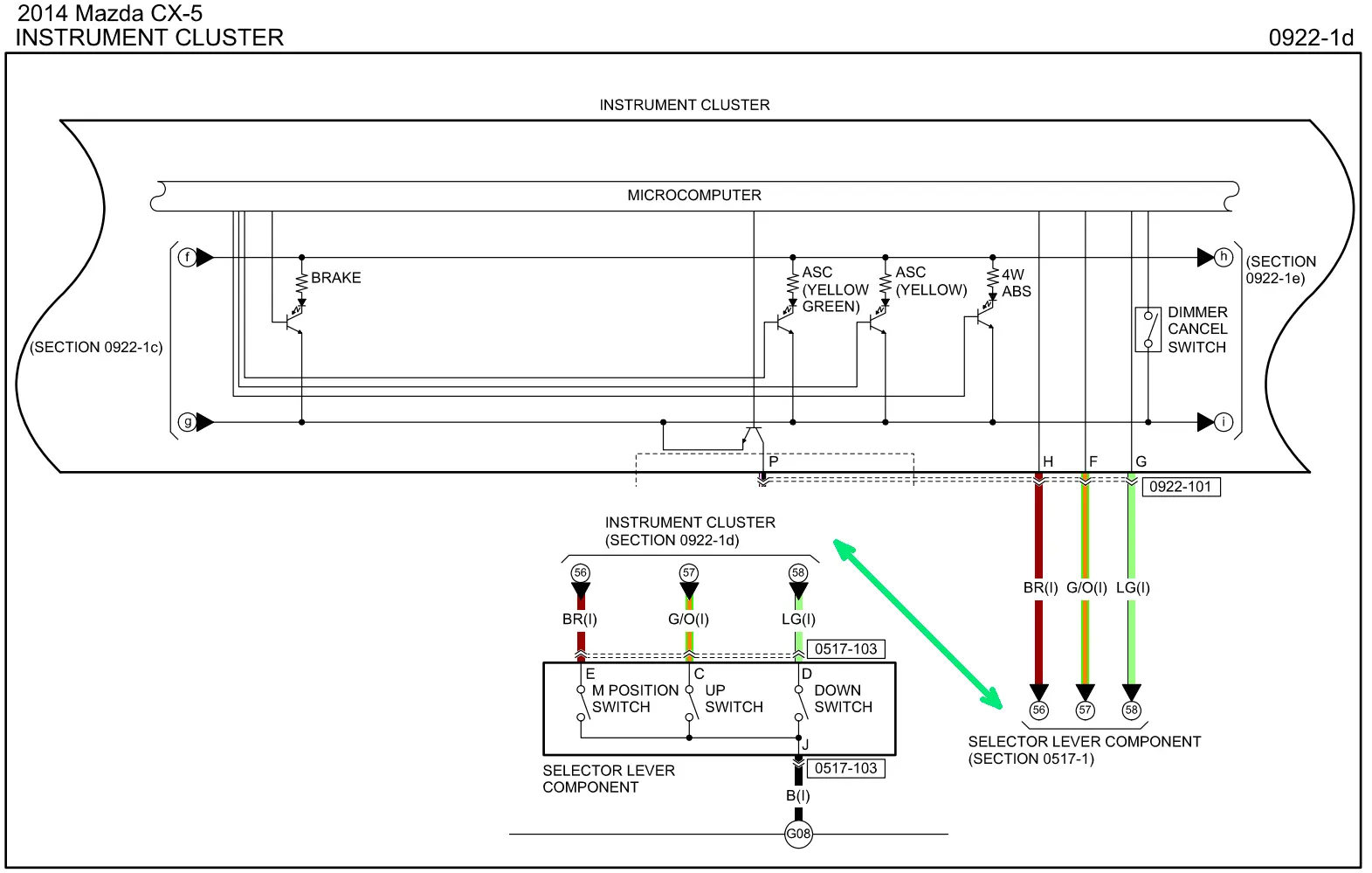

Looks very simple... just and 'Up' and 'Down' switch to ground. The switches in the shifter are wired directly to the instrument cluster, so should be an easy job to splice into them near the steering wheel. The only issue would be how to wire through the clockspring. There are a number of empty spots in the clockspring connectors, but no idea if those wires are populated in the clockspring itself.
Concatenation of two schematics for the shifter...

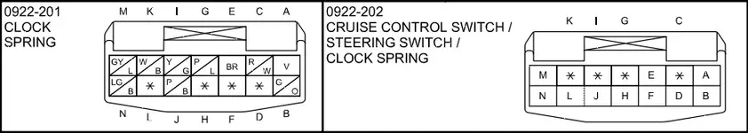

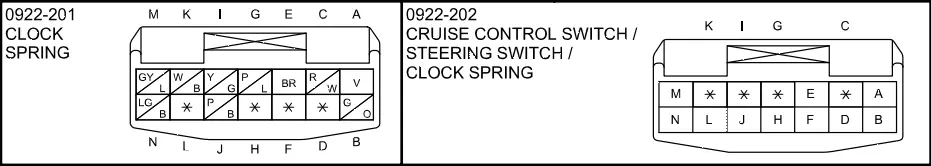

Clockspring connectors...

Cool! It looks like the author on the Japanese site was using 0922-202 for his connections:
But his diagram seem to imply position M is not populated while our diagram implies it is popluated. But from our schematic we would only need three wires, or two wires if we use an existing ground. So the paddles should work once the center shifter is set to the M position. Having the paddles would allow a new condition where the up/down signal can be toggled without the shifter set to the M position. I hope the instrument cluster will handle it gracefully and not crash. (boom03)
