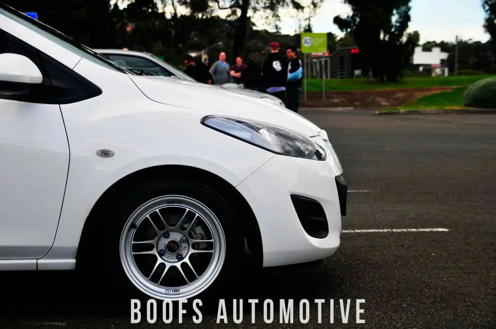

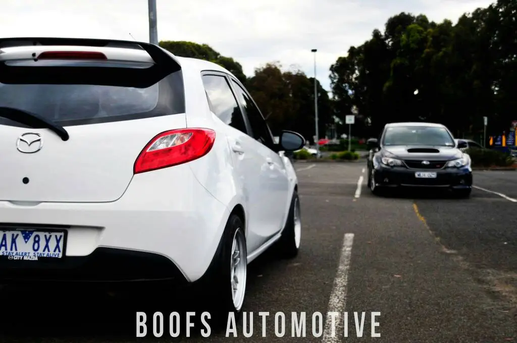

Just some pics of the new wheel set up.
Those new RPF1's are NICE. The higher offset I ran on my old subarus didn't look nearly as good. I'm amazed the 195 rs3s fit so well, I would've guess they were 205's from the looks of it.
Thanks guys. The fenders are not rolled.
No scrubbing as of yet. I did a mountain run and did not hear anything but I will keep trying over different roads to see if there is any. Hopefully there will be none.
