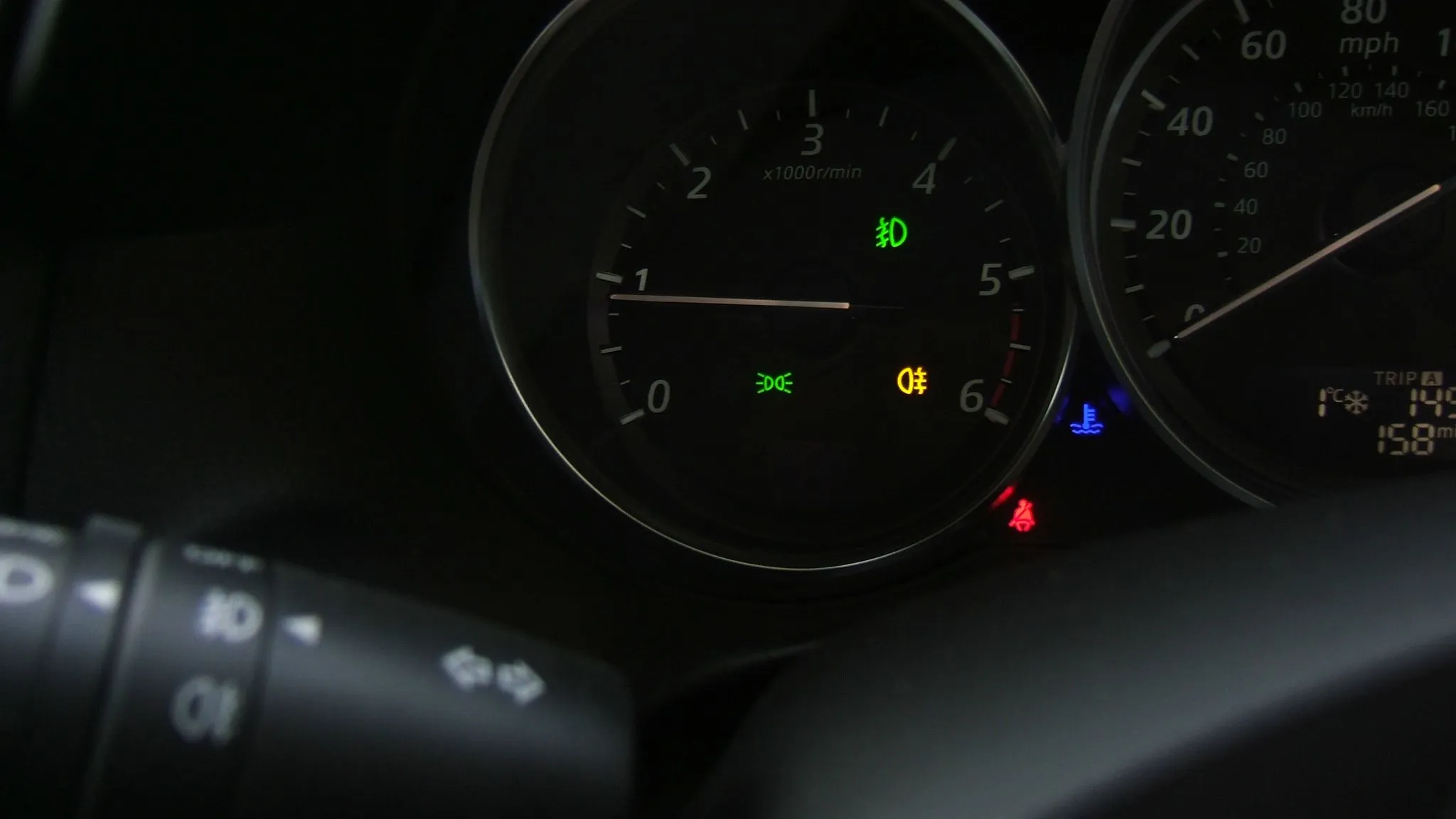

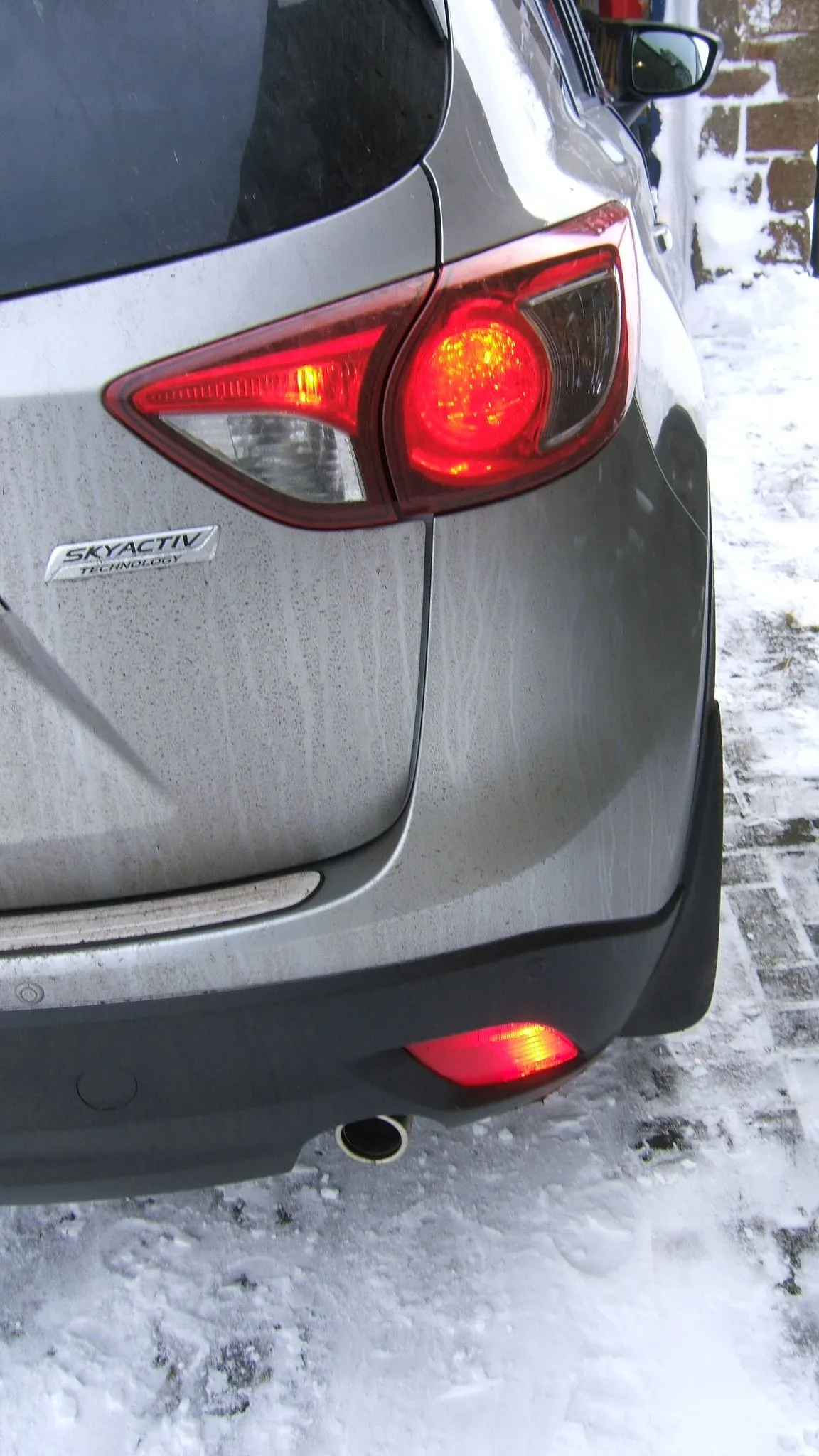

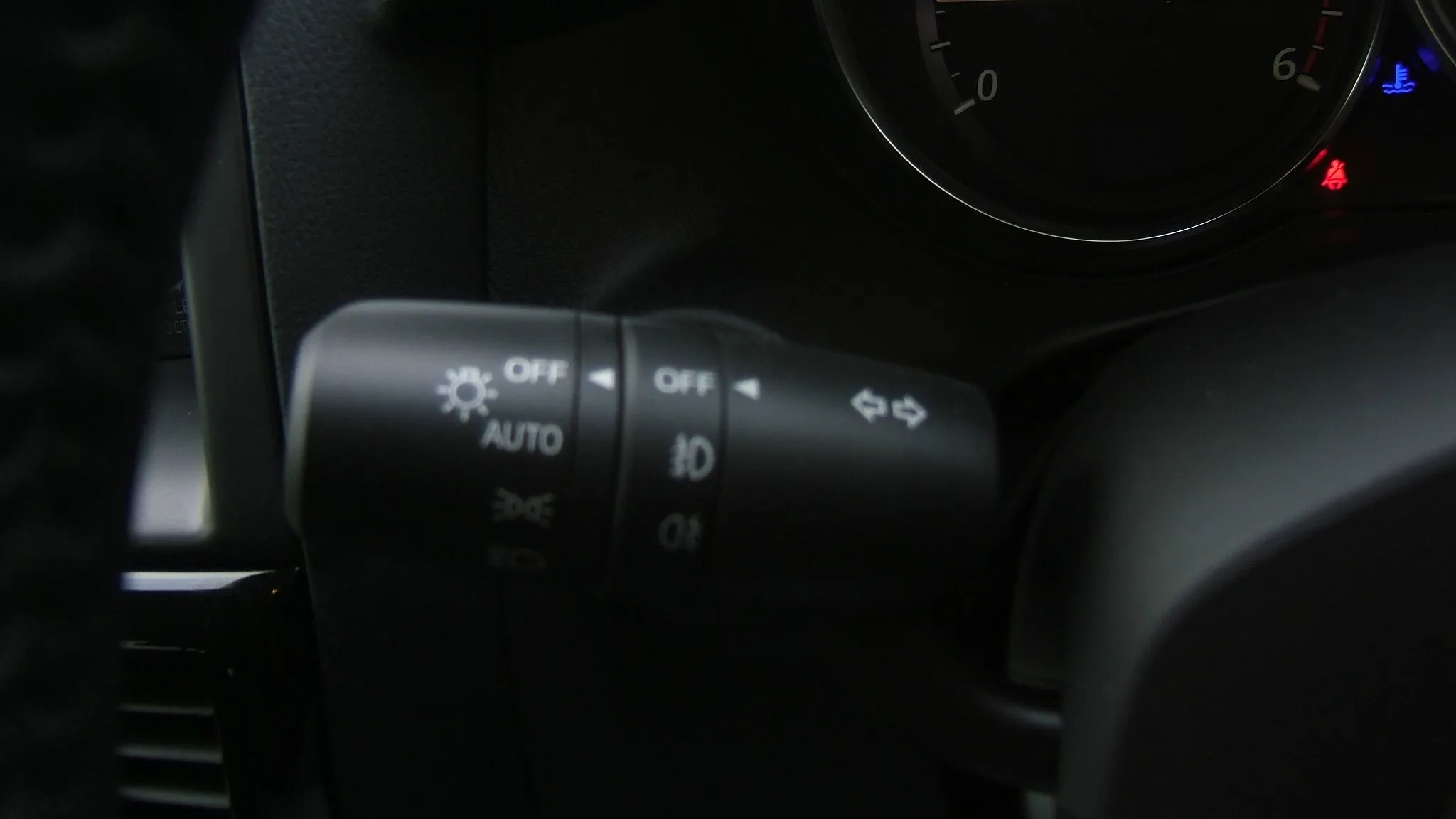

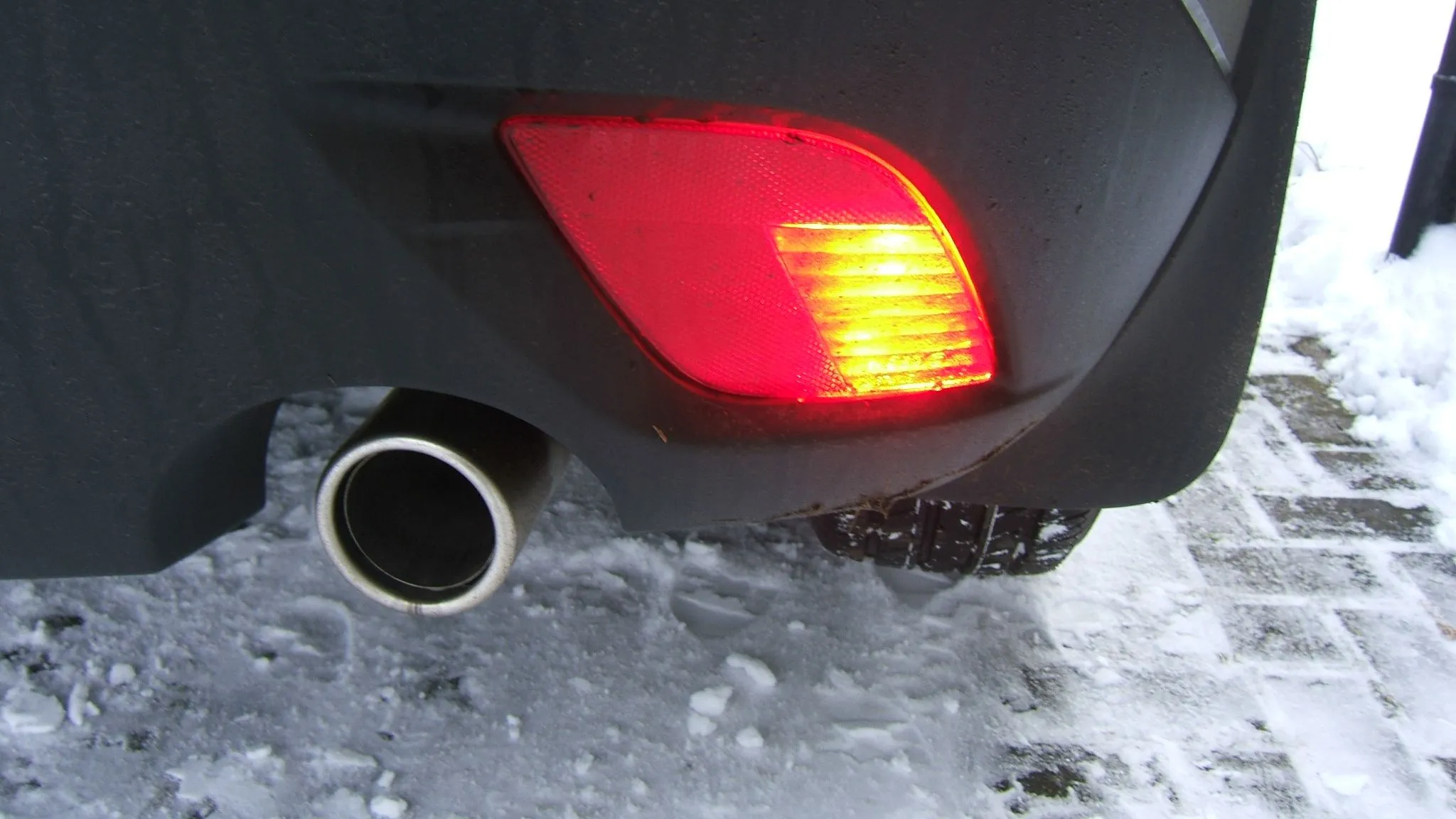

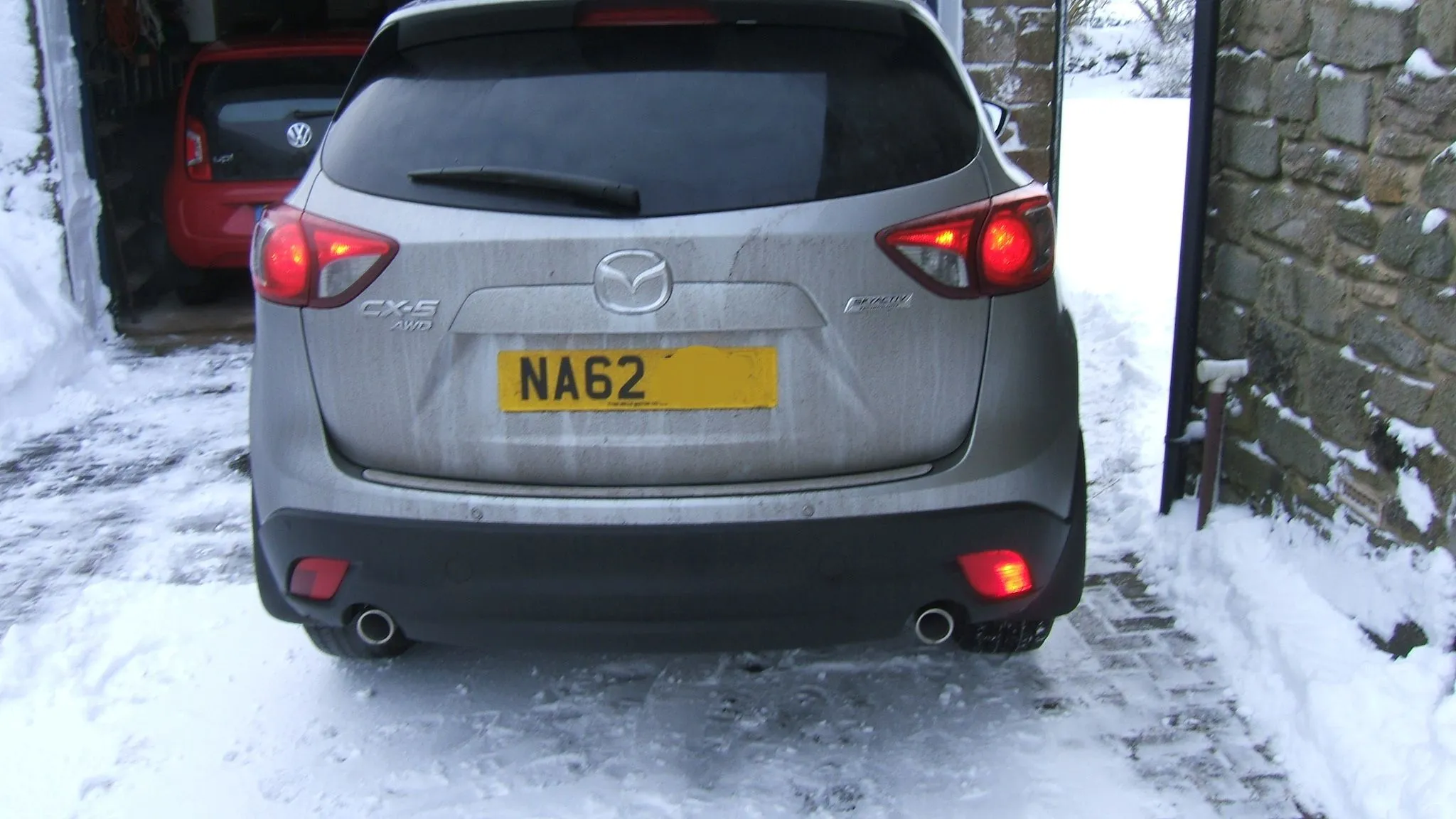

Hi Saynotopistons!
Hope these pics help.
The warning lights are for lights, rear fog and front fog.
The switch is contained in the light stalk on the steering wheel, the lights have to be on, then the rotar switch for fogs front and /or back, which is spring loaded and returns to front fog position. Sorry but there is no dedicated switch
The rear fog light is on the drivers side only.
Hope this is what you needed, sorry about pic quality of switch but auto focus kept going onto start button.......
Best wishes
JY
