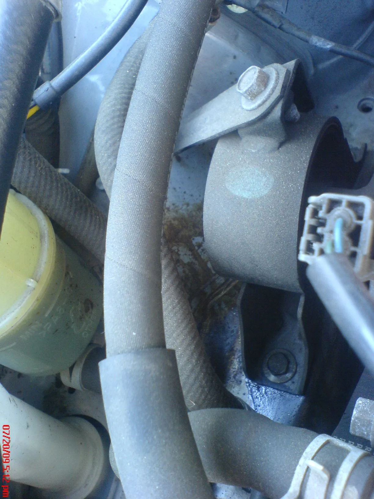

    Can anyone ID what that fluid leak is?? Does out engine mount have fluids inside?? also what parts is need to repair, and how hard is it??

    So meaning it can be repaired?? Can i get to it without lifting the engine?? and if i want to replace,what do i need to order??
    Quote Originally Posted by MMPS5 View Post
    just refill it with water or another liquid and reseal. KISS.

    I believe you would have to take it out to take the pressure off the mount and fill it.

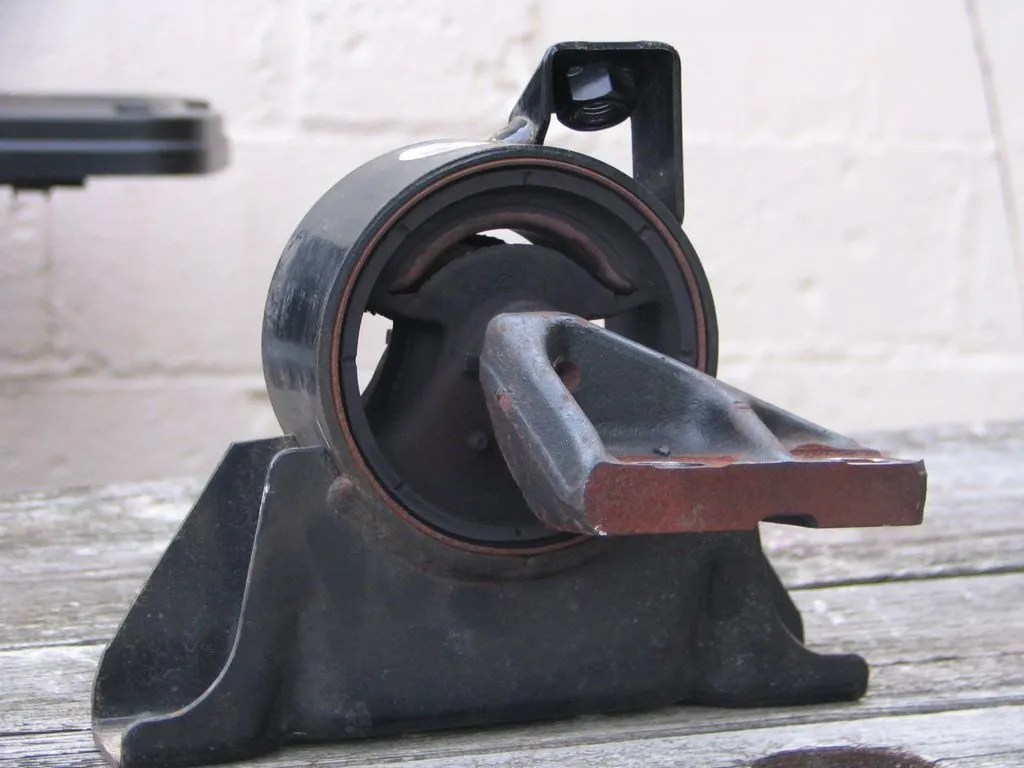

    I'll just replace it with OEM, cause it's just my DD. So i order the $105 side mount right? does it comes like as a whole set, or it's just the inserts??
    also how do i install this side mount??

    To my knowledge, the engine mount does NOT have fluid in it. It's just a rubber insert. The inserts that Psylence has linked to are inserts to replace the soft stock rubber with harder urethane ones.
    I have some extreme rusting in this exact location, and I've never been able to figure out why. Maybe there is fluid in there, but it's news to me.

    x2 these mounts are not fluid mounts, remember these are proteges, not m'benz's
    id say the fluid is leaking from the powersteering fluid resi that is visible just over the mount in the picture, being that thats the only logical place it would leak from and end up in the same area

    That's exactly what i thought too. But i can clearly see oil at the bottom of the side mount, and i see this post.

    the mounts DO leak fluid. I'm not sure why some do and some don't, but I can tell you that I had mine, it was ripped, and it was leaking fluid. It was not the power steering fluid or anything else. It was the passenger mount, I'm 100% positive and have no question about it.
    Its an 02 protege ES btw.
    Maybe it was replaced before, I'm not sure, I bought the car @ 91k miles.
    But I ordered a 120$ mount from some website, and i shook it, and notice it too had liquid inside it! It didn't come as just the insert, came as the entire mount.
    Mine ripped because of a car accident, but they do start to rot after 100k miles.

    To install:
    unbolt engine mount and anything that might get in the way (some hoses were in the way for me).
    Pry the engine toward the headlights (away from the rear, toward the front)
    to take stress off the engine mount, take the ripped one out, and put the new one in. While keeping the engine pryed with a crowbar the entire time, bolt on the new motor mount.
    Its a 2 person job.
    You'll need a socket wrench with an extension to get to the bolts.
    I've got the tools for the job and can help you if you feel like taking a drive to NJ. But you could probably find someone closer to NY.

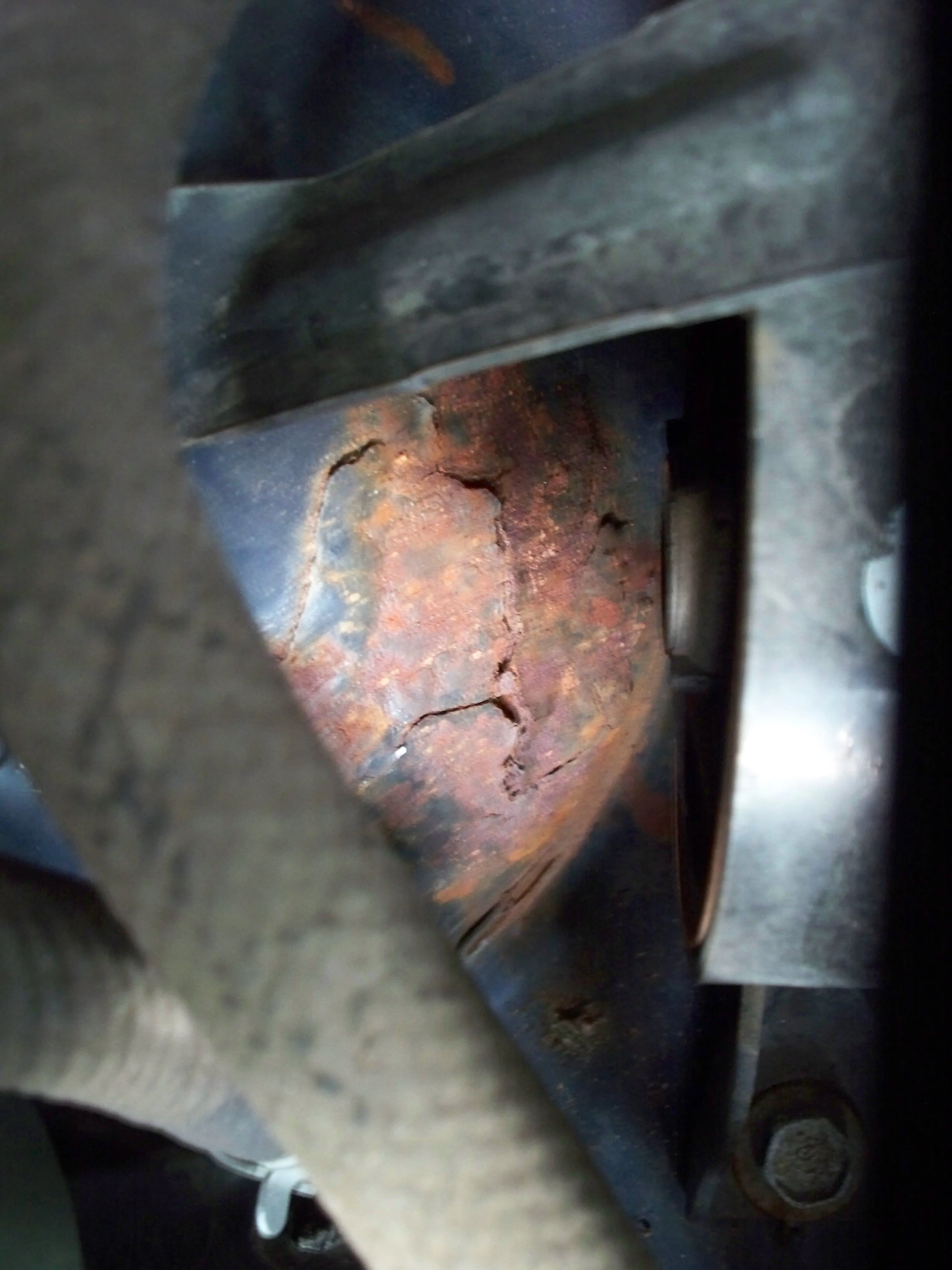

    Wow, this is news to me! If I could find my camera, I'd take a picture of how corrosive that liquid is. It's seriously rusted my wheel well there (just like the OP, only rusted). If I had to replace this mount, I'd certainly go with aftermarket to avoid this situation again (and for the performance gain).

    Found the camera (yeah!)
    Sorry it's a little blurry- it's hard to get a picture of that spot!

    Wow, that looks bad. How long did you left the fluid there to cause this much damage?? guess i better clean mines up right away. also Thanks social for the tips on install. do you think a jack under the engine will work??

    after 100K?? my car only have 46K on it. It must be the NYC pot holes.
    So i'm guessing the mount on OEM mazda @ $105 is also the entire set.
    btw did your wheel well area also rusted cause of the fluid leak??

    My first thought was to put a floor jack under the engine, but there was a metal bar there that was in the way and I couldn't get the jack positioned in a way that could support the engine.
    But a crowbar did do the trick.
    And the liquid didn't rust anything (i think), I haven't seen any rust but I wasn't really looking for any.
    I drove with the busted mount for about a month+
    I replaced it about 3 months ago.
    And the liquid is still there, eh I haven't gotten around to cleaning it up yet (encourage
