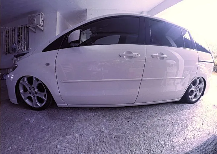

So can you drive that low? How's the turning you rub? Thanks for the side shot
Yes and carefully. Also fabricating a front skid plate and still want to be able to use the rubber plastic splash guard. Thinking that I might as well fabricate one for the center too and have her uniformed under a lift. Not taking any chances that can cause major undercarriage damage and have anything ripped off or crack anything important. As of the rubbing issues was resolved a couple days ago with heating/reshaping to the front and rolled rear/still has her splash guards on. Thank you and Your Welcome!!!
Rears:custom spring rates and length/non adjustable ride height w/adjustable rear shock cartridges/moogs adjustable upper arms.
Fronts:custom spring rates and length /adjustable strut cartridges/customed-fitted FortuneAuto sealed thrust needle roller bearings/onikyan plates/adjustable front links/2-point strut tower bar
Thanks. I was hoping for more technical details. Did you get custom springs made or are they off the shelf by some mfg? OR did you mod/cut/heat treat and reform a kit spring? What is the free length and spring rate of these springs?
What brand shocks/struts did you use in the CO build (Im assuming FortuneAuto kit?)? There arent many adjustable damper options avail in the Mazda world. Would be good to know who else is out there, especially in Asia/Pacific. How much stroke travel in the front/rear do you have work with?

326power
Fortune Auto
Tokico Adjustable
Onikyan Plates
Note: (Custom Build w/some modifications and weren't designed for the vehicle/universal. Except for the plates.)
Honestly the best thing to do is cross reference. See what can or what looks like it might fit and if not there's always a way to make it fit. Suspension is suspension, they all work the same way just with different characteristics and on user preference. It's good to do some research before making any moves. At first I used stock fronts struts w/custom coils non/adj. And the rear also custom coils but w/toxic drop shocks. Short, affordable and can do the job. It was dropped but just not the ride height I wanted. Then of course the option to upgrade and did a build. At the same time saving me alot of $$$ instead of buying an already built coilover systems or just buying something cause of its "brand". Putting a little of this and that mismatched branding can outcome to either be shity or can be amazed.

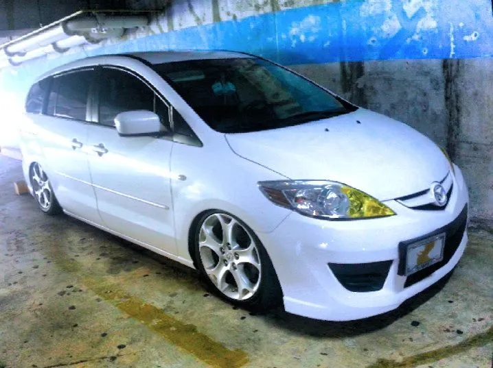

Mazda5 Premacy
She's lays closer to the earth and that's where she felt
everything was normal.

Over the weekend. My son and I enjoyed a couple of nights stay @pacificstarresortandspa
So the parking garage is some what spacious. The corner curved ramps enterance through the lower levels are pretty wide. On the flip side, the exit ramps are tight and narrow. A straight steep shot forward with no room for play in order to hit the ramp exit. With a Fucken Helllllllzzzz No!!!!! in mind...We parked and picked her front up a bit before getting settled in, just in case we needed to run out and grab a few things and guarantee when checking out 😂 Ohhhh Good Times!!!!!
Check out the link below 👇of our Mazda5'Premacy Drivelapse as we exited from our stay......Her rear was bottoming out tho.. that booty tapping the pavement lol
https://youtu.be/jf53Yjz1KGk
11th commandment :D
On a serious note, did you ever measure the max degree of your approach angle? Simple triangle measure from lip to tire with loaded/unloaded car?
