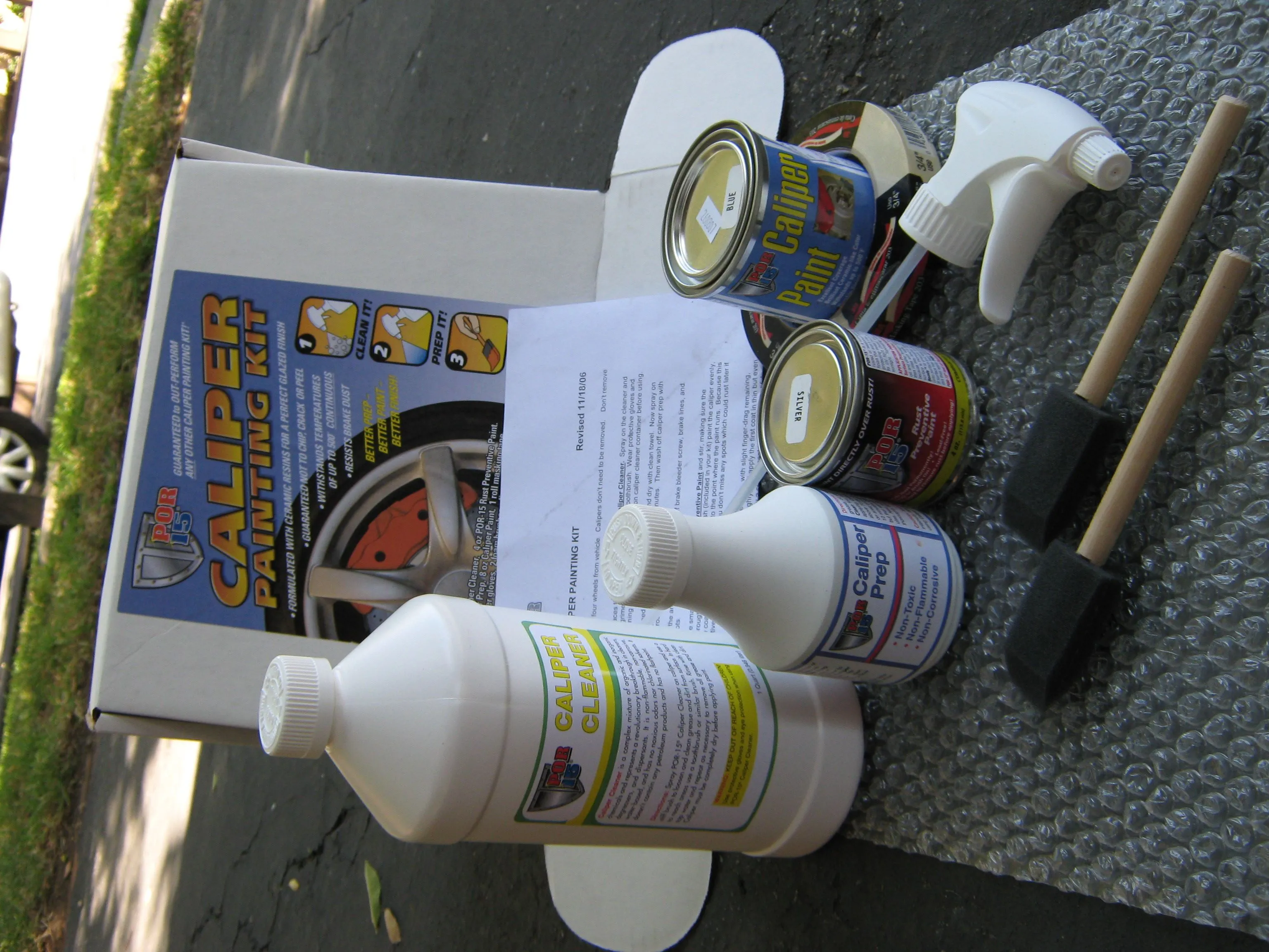

Now I purchased the POR-15 Caliper Painting kit. It comes in five colors: Blue, Red, Yellow, silver, and Black. The contents are as follows.
4 Oz. silver POR-15
8 Oz. caliper paint
4 Oz. caliper prep
1 quart caliper cleaner
2 foam brushes
2 pair latex gloves
masking tape
I ordered blue and recieved it in five days. Naturally I got to work right away. The instructions for the kit was a one sided page with six steps. painting

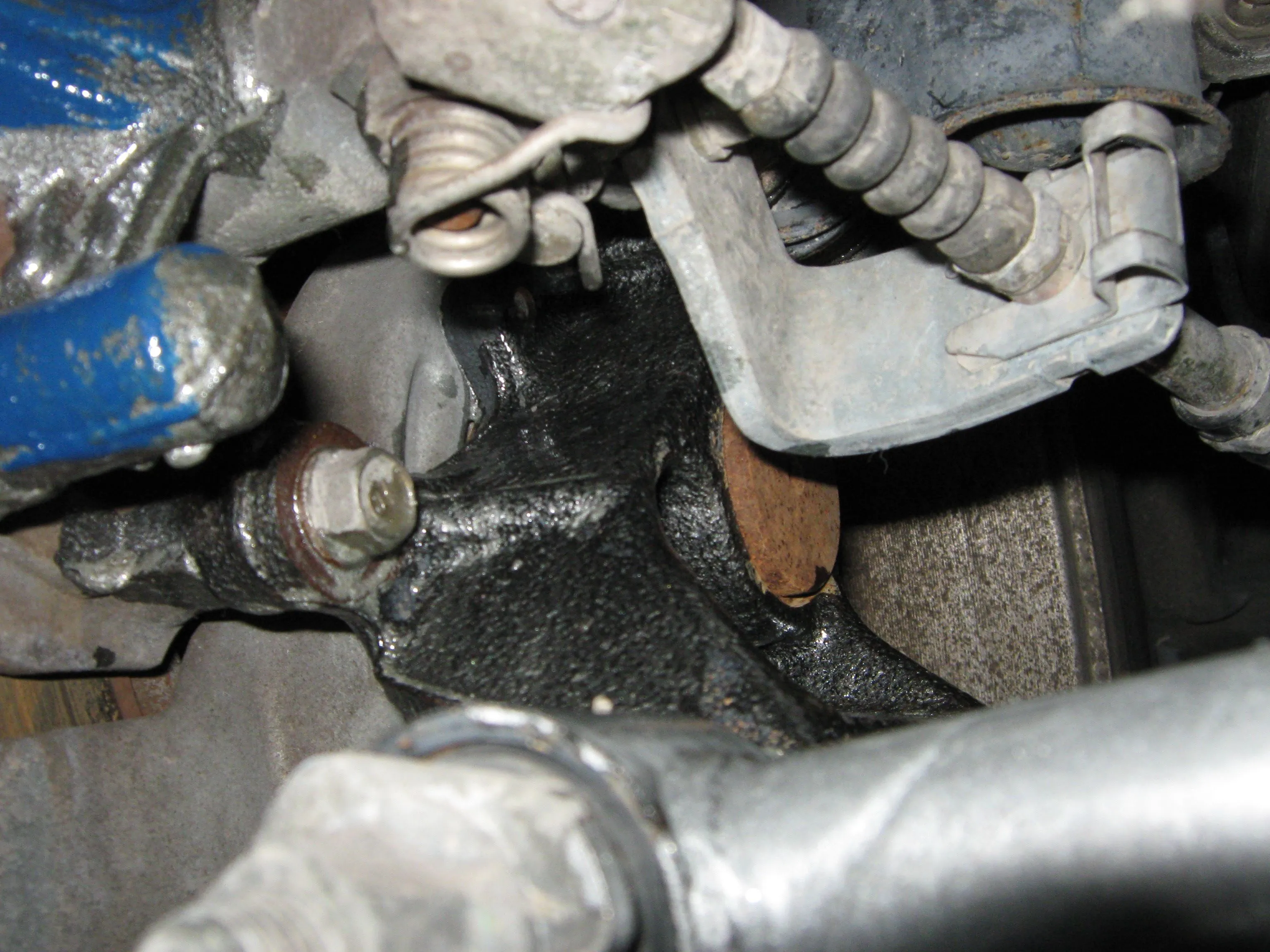

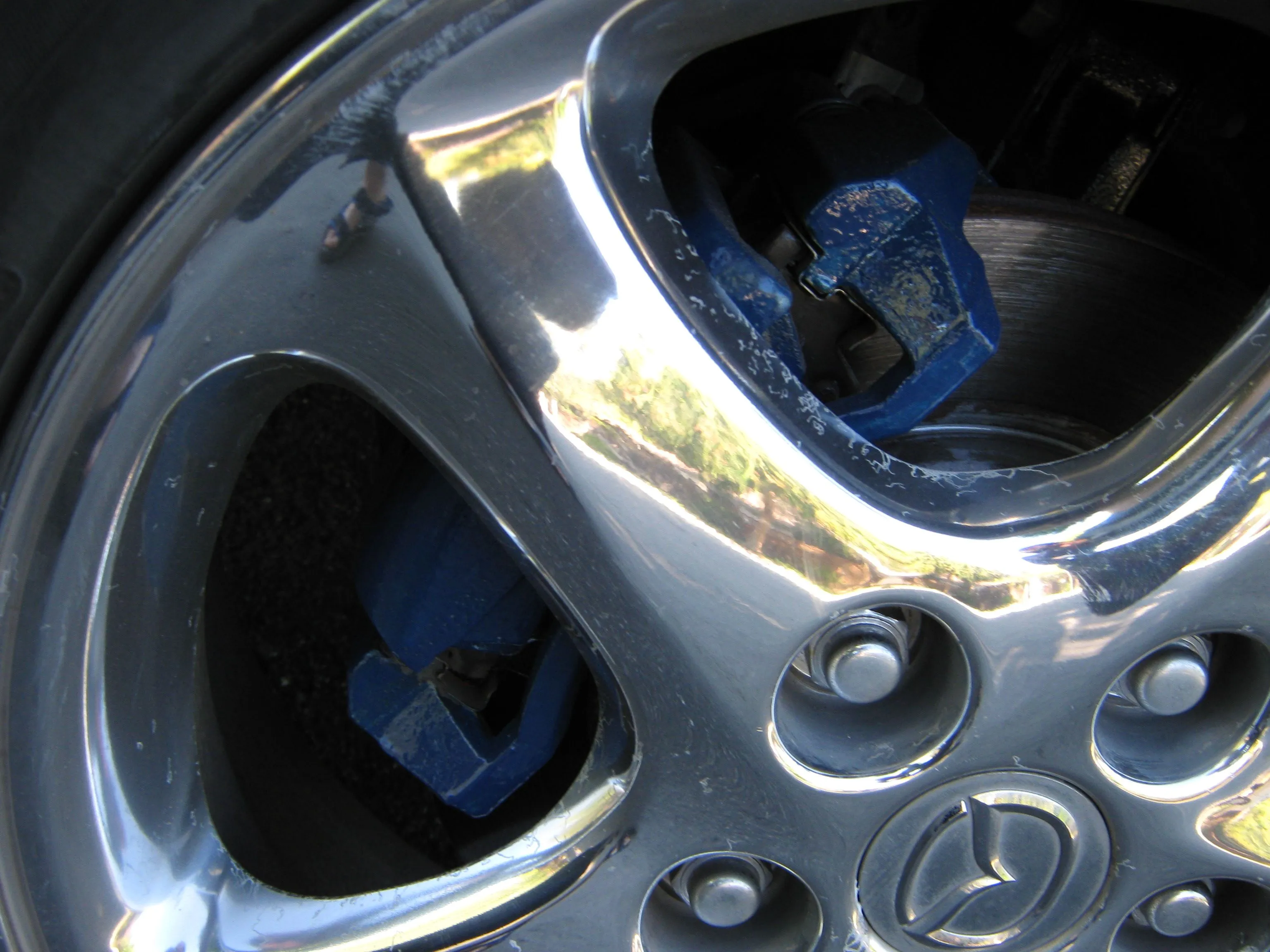

After a three hour waiting period, I saw first hand wonderful personality of pOR-15. It leveled out wonderfully. In three hours the paint had
hardened to about motor mount rubber material. It was smooth and I felt confident this paint would survive the harsh jungle streets. I was very pleased with the progress. It wasn't until I got to the caliper paint I was discouraged.
It is possible I waited too long before applying the caliper paint. The manual does once mention "When your POR-15 coating is just dry to the touch,
with slight finger drag... apply the first coat [caliper paint]." I did not understand clearly what finger drag meant. At one point the paint "glued"
to a finger but 20 minutes later it was dry as rock. Perhaps meticulous paint curing observation is required, but as far as my experience, the caliper
paint did not satisfy. The first coat did not level well at all. Paint brushes remained. A thick layer was required to hide the metalic POR-15, which
spawned dripping. After the second coat, the product codes the calipers once held were illegible.

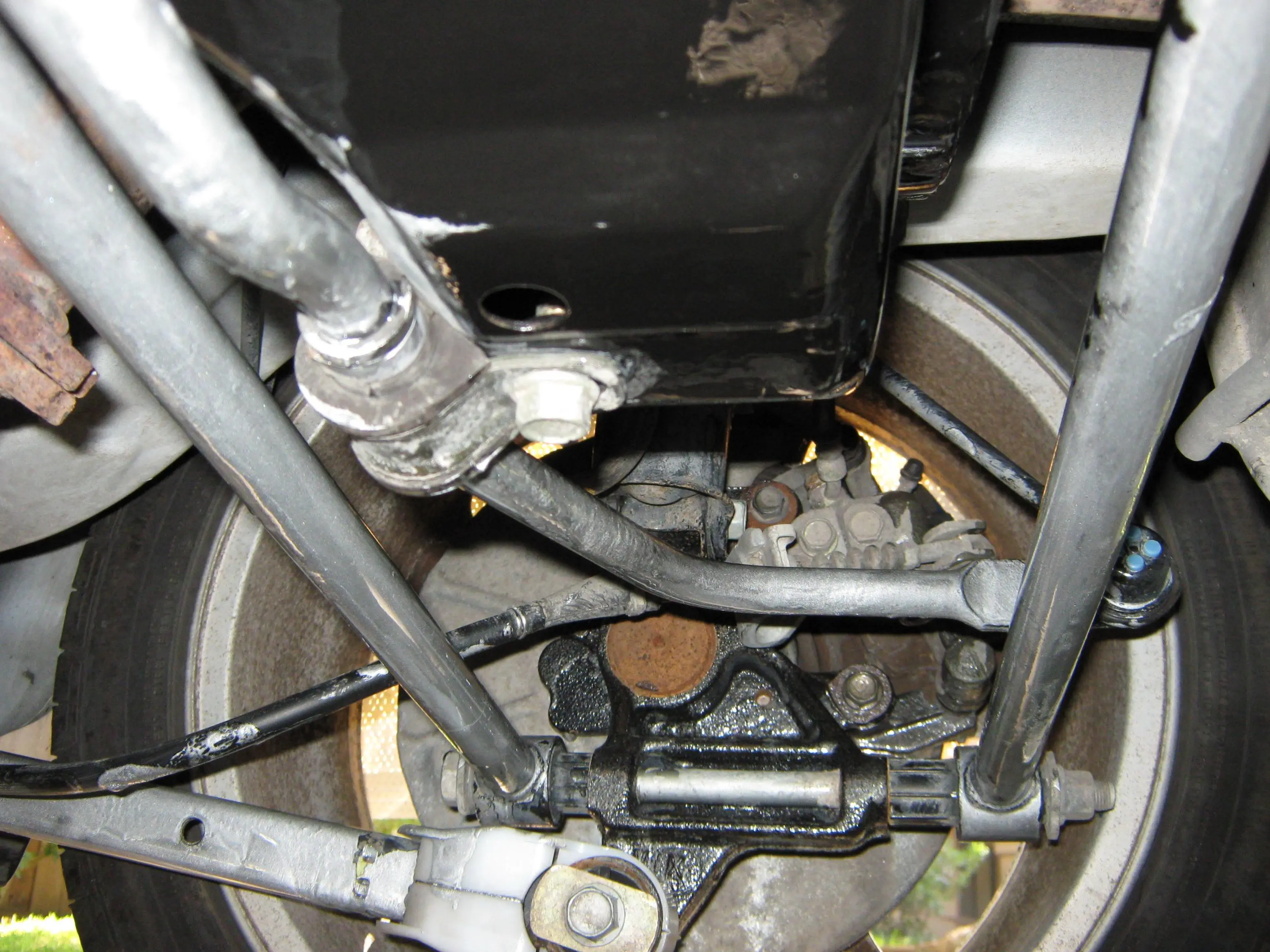

But all joy was not lost, I had yet to see POR-15 on a solo job.

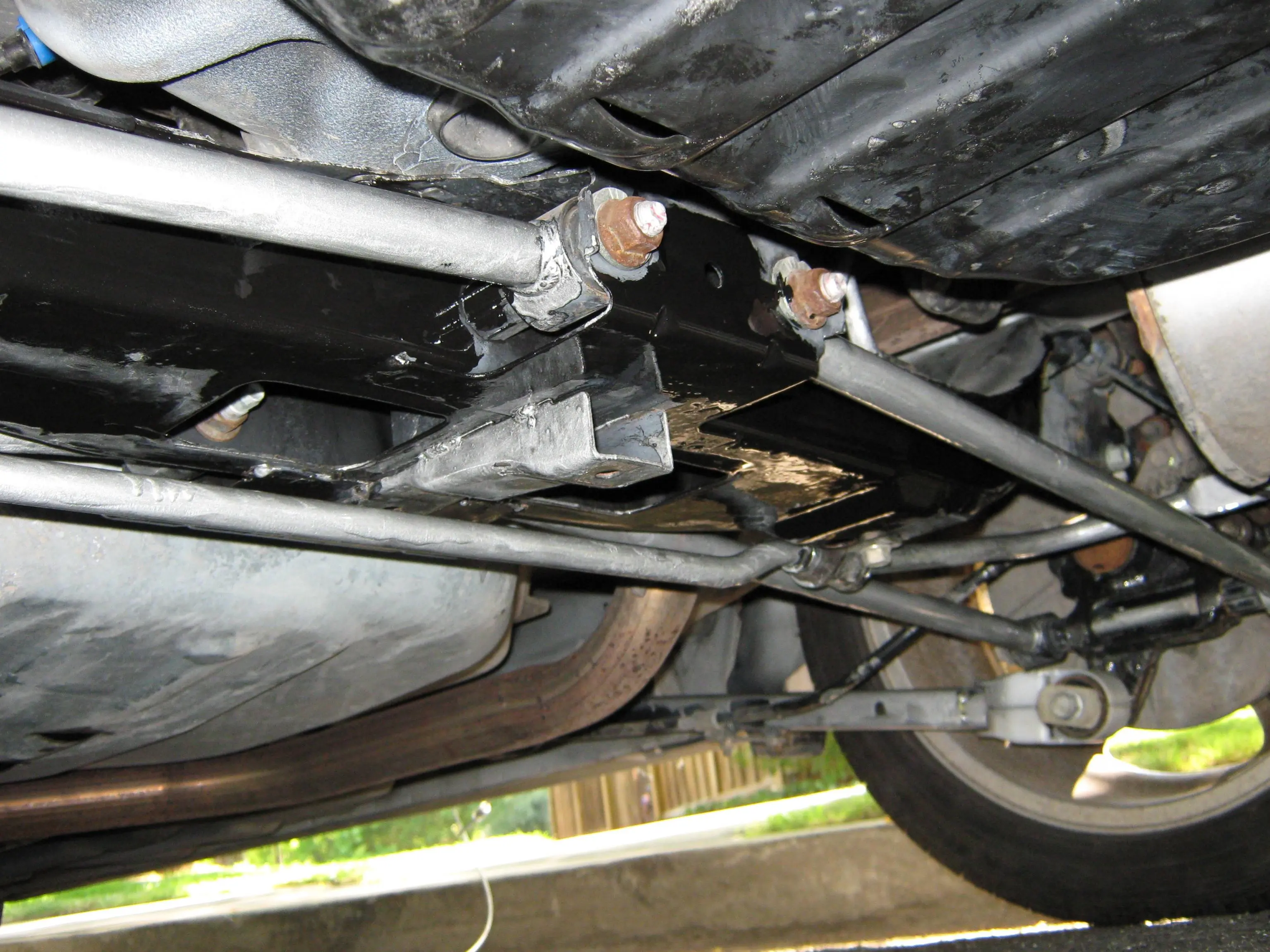

I had the priveledge to handle POR-15 many times since summer began. Although to use POR-15 outside of the caliper kit, I had to purchase the paint, which is already quite expensive, Metal-ready, Marine Clean, and the Solvent. POR-15 has a hefty pricetag opposed to competitors, like Rust Bullet
which does not require expensive prep products. Now that I had POR-15, I set out to paint the undercarriage. The rear sway bars and crossmember went
very well, despite my clumsiness. POR-15 spread smoothly over the sway bar. With proper stirring, the paint was gorgeous. Not only that, but
the black POR-15 had even better leveling characteristics than Silver. You can see the very clear surface of the newly painted crossmember. I'm very
satisfied with the effort. All metal surfaces painted have a very soild coat. The Caliper paint job has not chipped, cracked, or peeled for three weeks.
I'm confident it will hold strong after three years.
