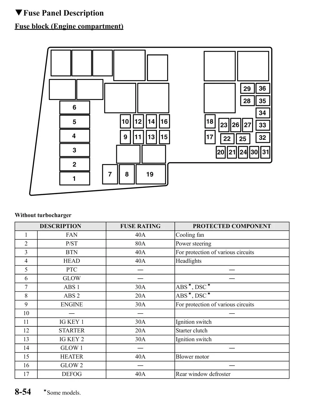

    My cigarette lighter does not work for me to charge my cell phone. Where can i find the fuse for this? I did not see it under the hood, where is it and what type of fuse please? Thanks

    Though I just realized you have a 2006... This might still include you.
    This is from the 2007 Owners manual. Engine Compartment fuse box. Fuse 29 is labeled as Power Outlet.

    the fuse box is under the passenger side
