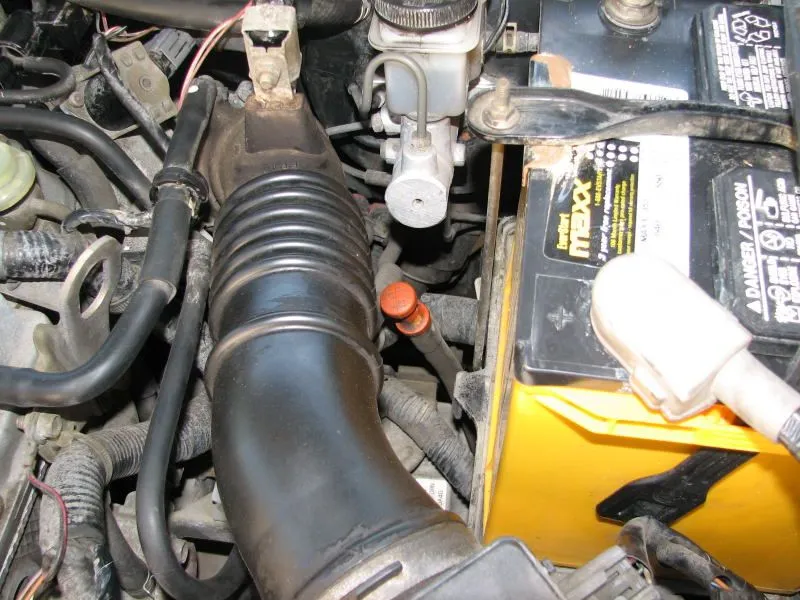

    in what side of the engine bay is the transmission dip stick located? I was looking at my engine bay the other day and did not see it. Also the OP said his car is a 2000, is that the same for 01,02 and 03? My car 141,000 mile, I got it about 3 weeks ago and I am trying to figure out all the maintance normally is done on the car beside the 3k oil change and other stuff.

    pic of auto trans dip stick, 2002 ES
    Here's where the one in my car is (2002 ES). It has an orange top.

    ^ ok thanks.. thats way I never saw it lol since it is behind the MAF. How can I tell if my car have a transmision filter or not if it is in side the oil pan?

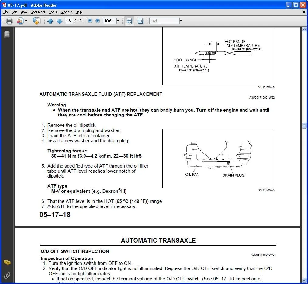

    The only mention of anything like that in the manual is specified as a "strainer". This is not something that is typically changed, at least that what it looks like to me. I've attched the fluid draining procedure.
    Maybe the best thing to do is to call the dealership and ask the service person.
