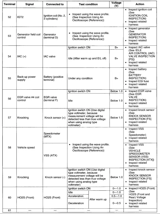

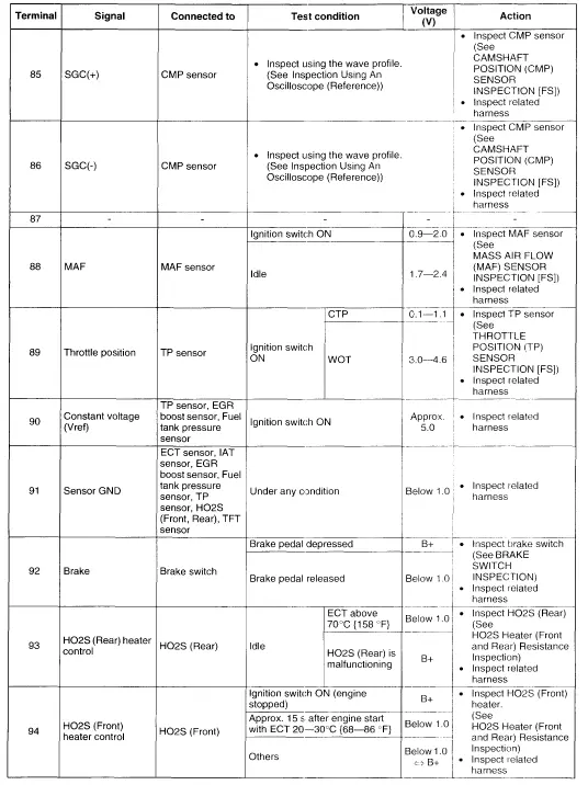

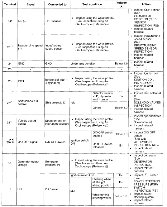

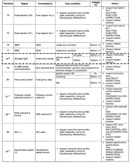

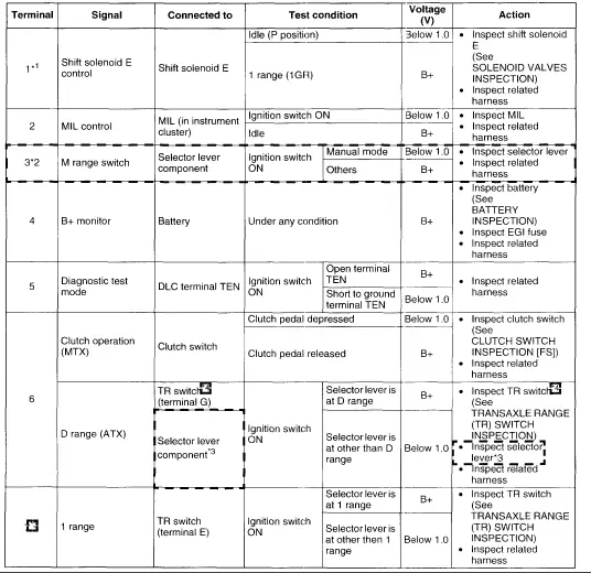

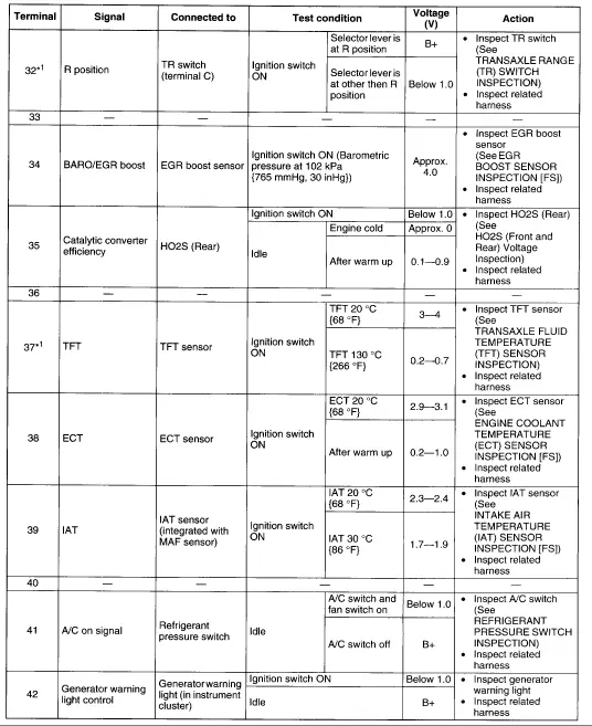

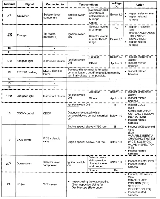

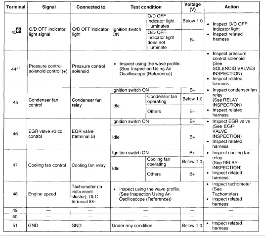

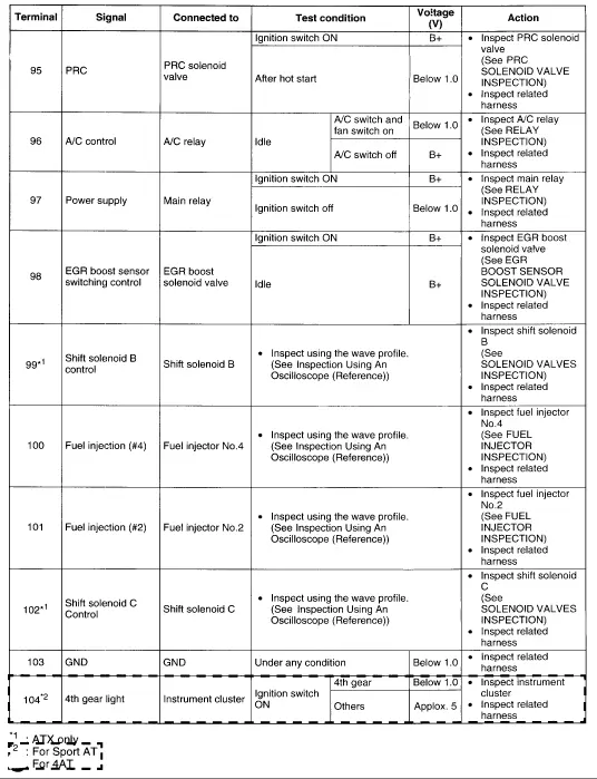

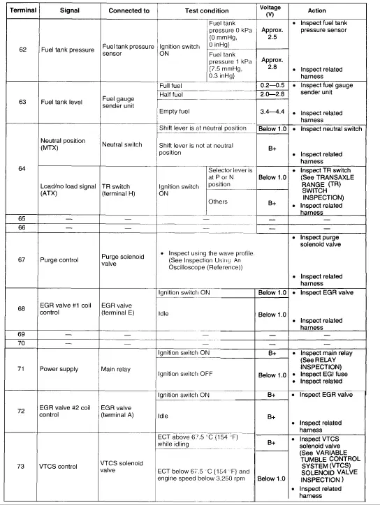

I'm trying to install my HKS CAMP system and my SS AFC and would like to have a diagram for the MSProtege ECU?? Does anyone have a copy or something that I could use? BTW I have searched the forum. Thanks.
You might also find the link in my sig to be helpful........edit...they took down the site
heres the long version. very very detailed tho

Not a problem hope that helps. Let me know if you need anyhting else. Being a head mechanic/manager at a shop has perks like access to alldata. I also get parts at wholesale which saves $$$.
