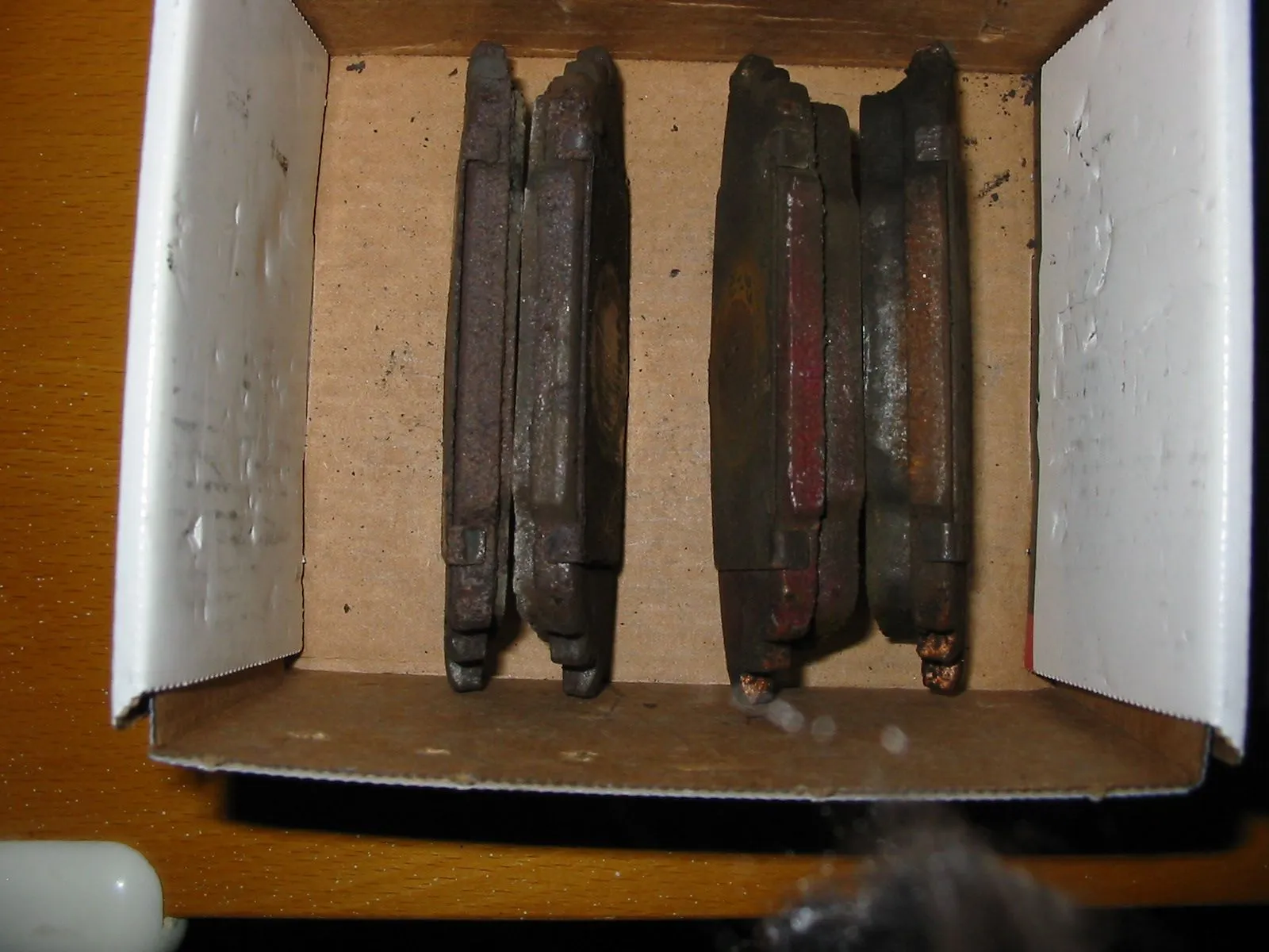

The problem started when my rear left caliper was intermittently sticky. You can see the difference in wear between the pads below. The rear left pads were far more worn down. I plan to replace the left caliper assembly with a remanufactured unit in the near future.
