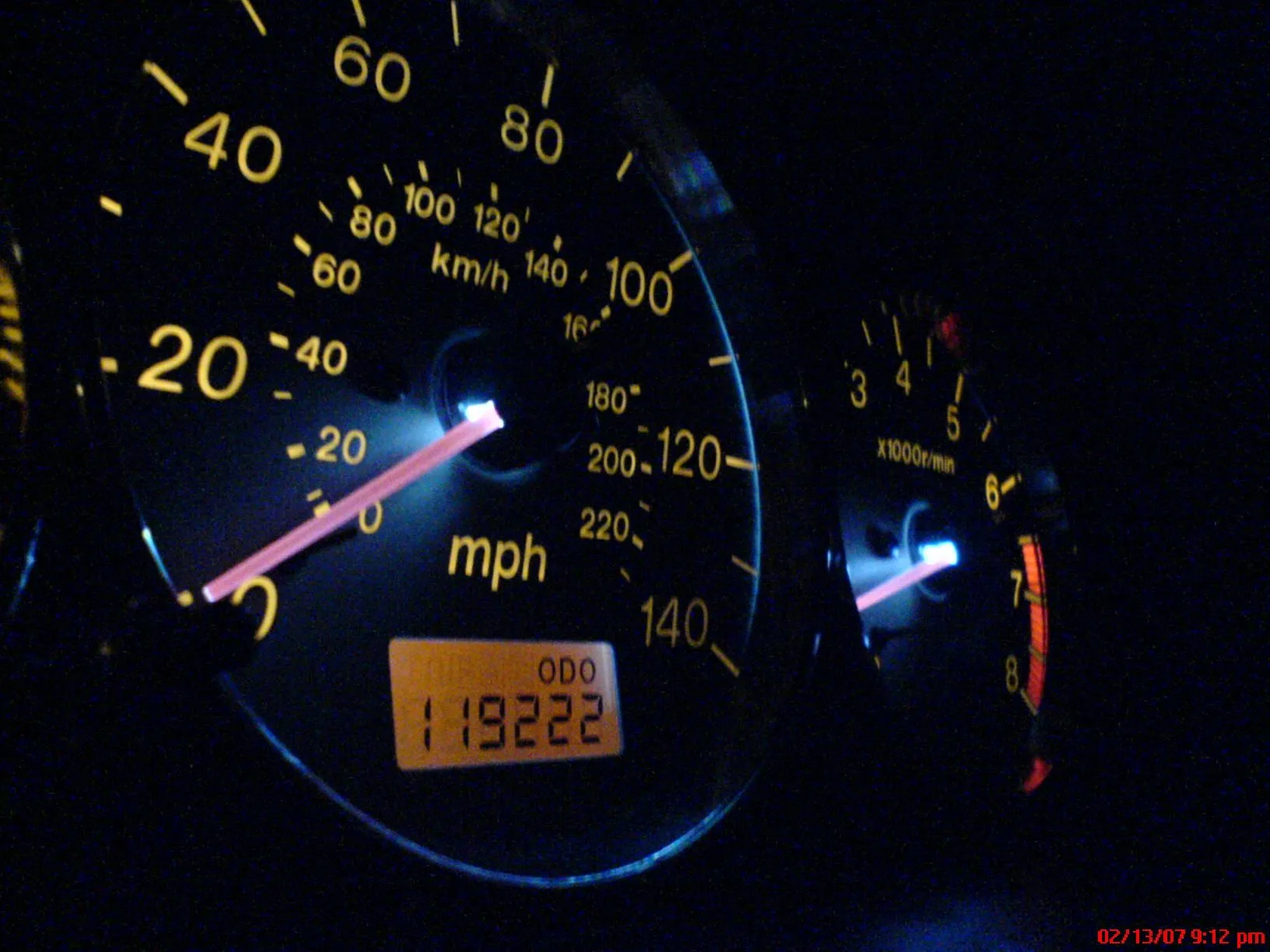

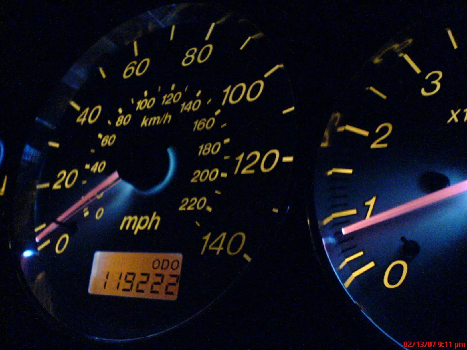

these are the only pictures i have of my gauge cluster at night (see attached)
i also changed out the bulbs in my HVAC to red led's, but that wasn't as easy. you have to remove it from the dash, and take it all apart. plus, the amber/orange color is not fromt he bulbs, but from a transparent piece of plastic between the bulbs and the face. thats the only way to get the blue on the temp knob to light up blue. with the red led's, i get no "cold" illumination at night. i'm still trying to rig that up better.

yes it did - mazda used a combination of the condoms and gauge film to make and even color across the gauges
