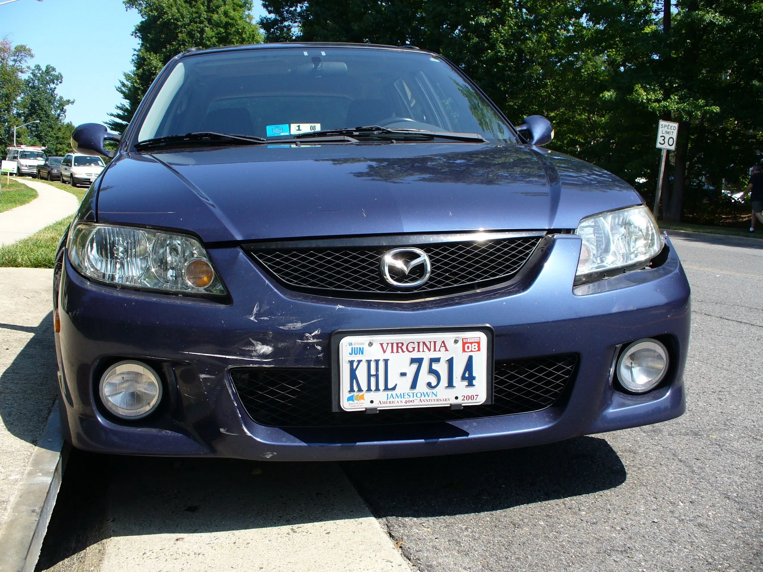

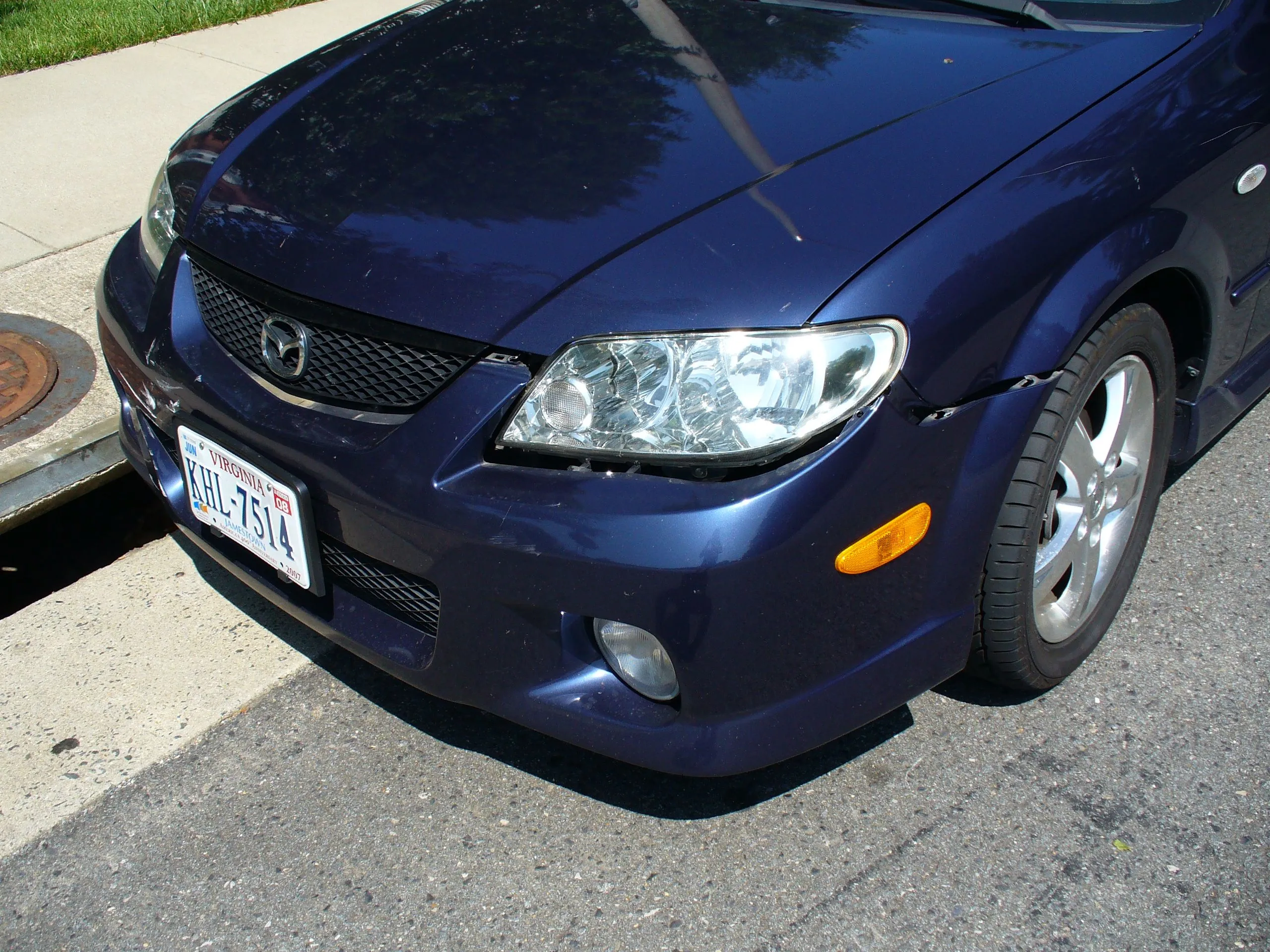

Anyway, last night some jerk nailed my front bumper and took off (I think I found the car that did it though!) I was looking at the bumper and popped the hood and noticed that I'm leaking an oily liquid around the passenger side motor mount. I can also stick my finger through the rubber part of the mount (I'm thinking thats going to need to be fixed soon!). The rubber is really oily. All of the other linesrunning around it look good (AC and PS) I just had the car in to get the oil changed and checked out since I just purchased it and it looked good. Definately no oily mess then. Car is running fine.
Do the P5 mounts get packed with oil or some sort of liquid? Could the impact of the accident (the car got pushed into the curb and good 5 inches or so) have caused the mount (or something I can't see) to leak????
Here are some of the carnage pics:(

So how safe is it to cruise around like this? I was thinking they were a bit worn since I get some rocking motion at low speed between shifts/takeoff.
Could the accident have caused the mount to fail? In hte pics it doesn't look too bad but the skid marks tell a different story. I got their side marker housing as a souvineer and it led me to their car :) Saturday started out CSI style!
