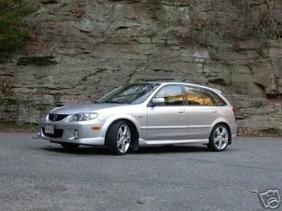

Here's a picture of Racing Beat springs installed on a P5, if you can't wait for my installation shots.

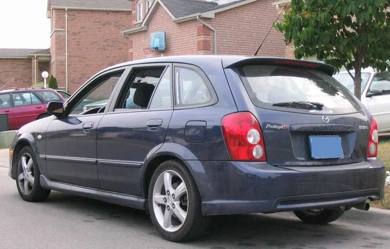

Here's my old setup.
Just MP3 springs which AFAIK came from an MP3 and said Racing Beat on it.

^A beautiful example of what happens when you use MP3 springs without MP3 struts.
I started this thread to clear up the ambiguity about the differences between MP3/MSP/RB springs: do you have photos or anything more concrete than "AFAIK"? I'd be interested (and surprised) to know for sure if the MP3 springs say "Racing Beat" on them.
Both drops are lower than I imagined. The P5 with apparent MP3 springs does appear a little lower in the rear. The other one is shot at a dramatic angle and the (RX8?)wheels make it difficult to tell about the actual drop, though the photo does make the car look great. JoshP5, are you on factory rims?

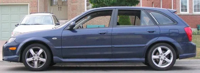

booom was running Mazda3 rims, not RX8. I attached another shot of his car at that time. I'm on aftermarket 16x7s, 40mm offset.
The MP3 springs on that P5 lower it like the goldline springs did my car.. quite a bit lower in the rear than the front. Definitely good to get springs made for the hatchback instead of hoping sedan ones will work.
The reason MP3/MSP springs drop the rear so much is because the short rear springs were designed to be used in conjuction with MP3/MSP struts, whose rear spring perches are mounted higher than the usual position.
Use of MP3/MSP springs with stock struts, regular HPs, or Illuminas results in too much rear drop--and I wonder if they even fit tight between the spring caps when the suspension is fully extended.
When used together MP3 springs should drop a P5 ~1/2" even. Maybe nominally more in the rear due to some additional wagon weight.
