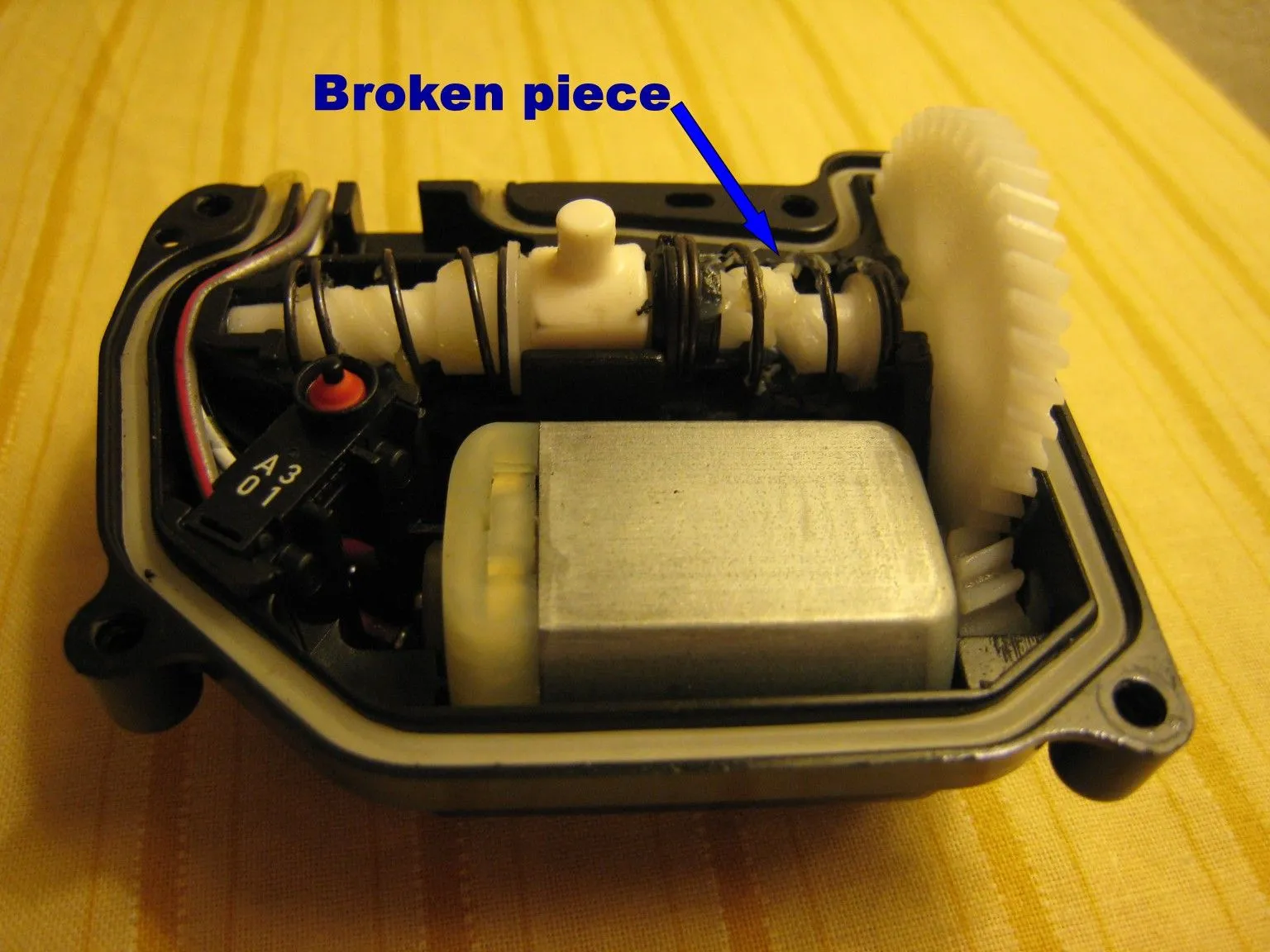

Recently my door lock actuator stopped working, last weekend I finally replaced it. It was fairly easy only took me 1 hour and a 5 min. beer break. Anyway, I decided to further examine the old door lock actuator, why did it stop working. I openned up the electronic piece and found one of the plastic gears broken. It looks like cheap plastic to me and that motor looks like something from a battery operated car toy.

lol, it looks exactly like the motors from those japanese car toys! I think it's a very common motor, though.
My left rear door just recently stopped opening from the inside. I'll have to pull off the panels next weekend and see what's up...
Yeah, that does look like some pretty cheap plastic. :(
Welcome to the wonderful world of technology..Make it cheaper,lighter and faster.

Same thing keeps happening on my 2001, with the same gear failure. I'm replacing the driver side actuator for the 3rd time. Seems like the worm gear is under-designed. I wonder if the small limit switch is supposed to keep the actuator from being overdriven - like when you hit the door lock on the key remote and the door is already locked?

Fixing the plastic worm gear
Your photo of the worm gear explains the problem well, it really is a bad design. 2 years since your posting and still no suppliers of the 50 cent plastic gear. The dealers want $200 for the combined door lock mechanism and the wreckers want $160 for the same. I drilled a 1.5mm hole up the centre of the plastic gear and superglued a nail in place, this meant the auto lock worked well but I was slightly off line in my drilling so the manual interlock becomes too stiff to work. This is because the worm does not liked to be pushed the other way, any friction is magnified and being slightly off line some binding occurs, lubrication of the plastic does not help, they are probably better dry.

Oh, junkyard is good too, just to get by, but why take the door apart just to have junkyard part fail the same way only sooner?
Since I posted this I have replaced 3 other door lock actuators. Today, it happened again, driver's side, that's the 2nd one on that door. This really sucks! I don't think I'm going to replace these actuators anymore, I GIVE UP! Don't like to spend $40 per actuator per year, that's just riduculous.
