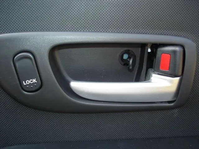

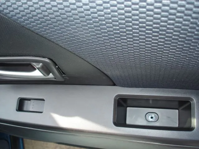

basically yes the procedure is the same. 1 screw is in the door latch, the other is in the pocket in the bottom of the arm rest. But be careful, those little white plastic anchors break really easily!! When I removed my front drivers door I discovered that a couple of the fasteners weren't correctly fastened from the factory!

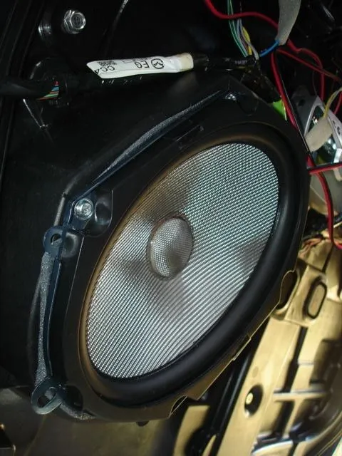

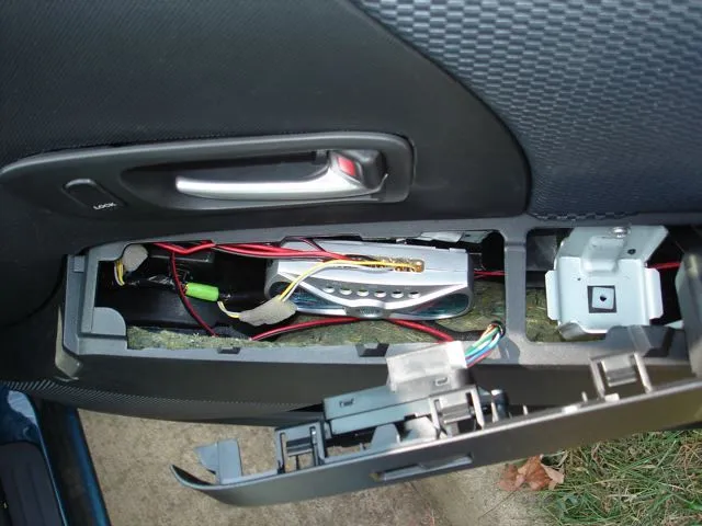

I'm working on replacing the door speakers and found there's also a large cavity underneath the door pull. Looks like enough room to mount a sizeable crossover. I think the speaker mount is plastic with room to force a 6.5" with some work - I purchased the Infinity Kappa 680.7cs which has 6x8's barely larger than OEM, as well as crossovers the size of a small paperback. I'll post a pic later this week once it's done.

door latch: cap flipped back and screw removed
door pull: cover & screw removed
door pull detached and pulled upwards to reveal space taken up by Infinity Kappa crossover
Infinity Kappa woofer in factory speaker position
